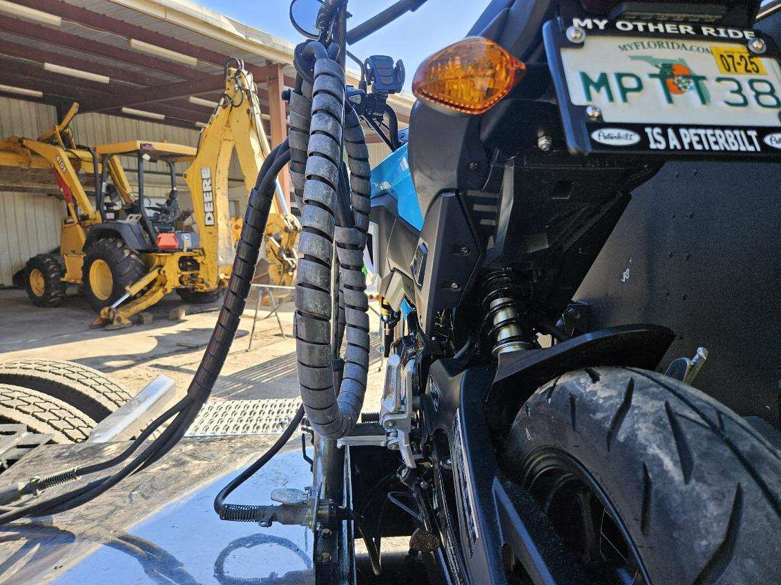

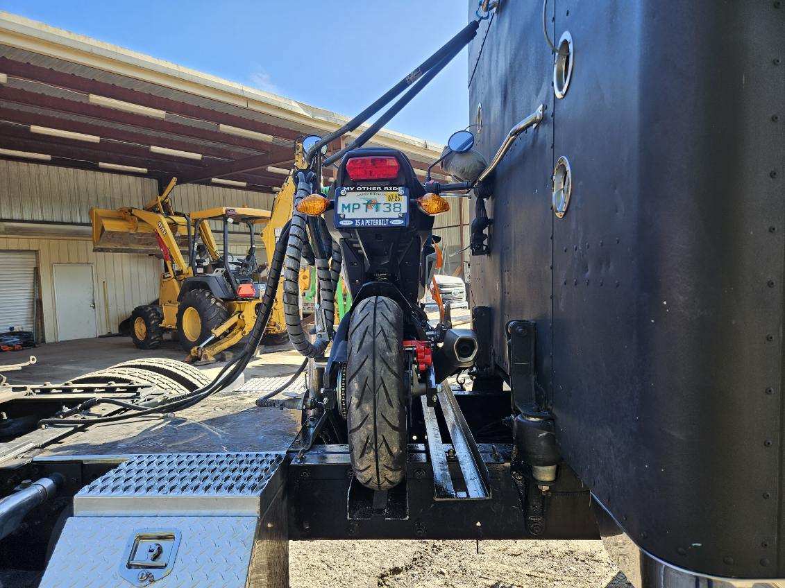

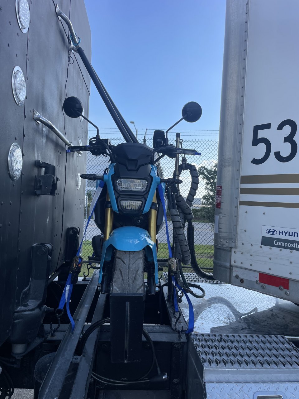

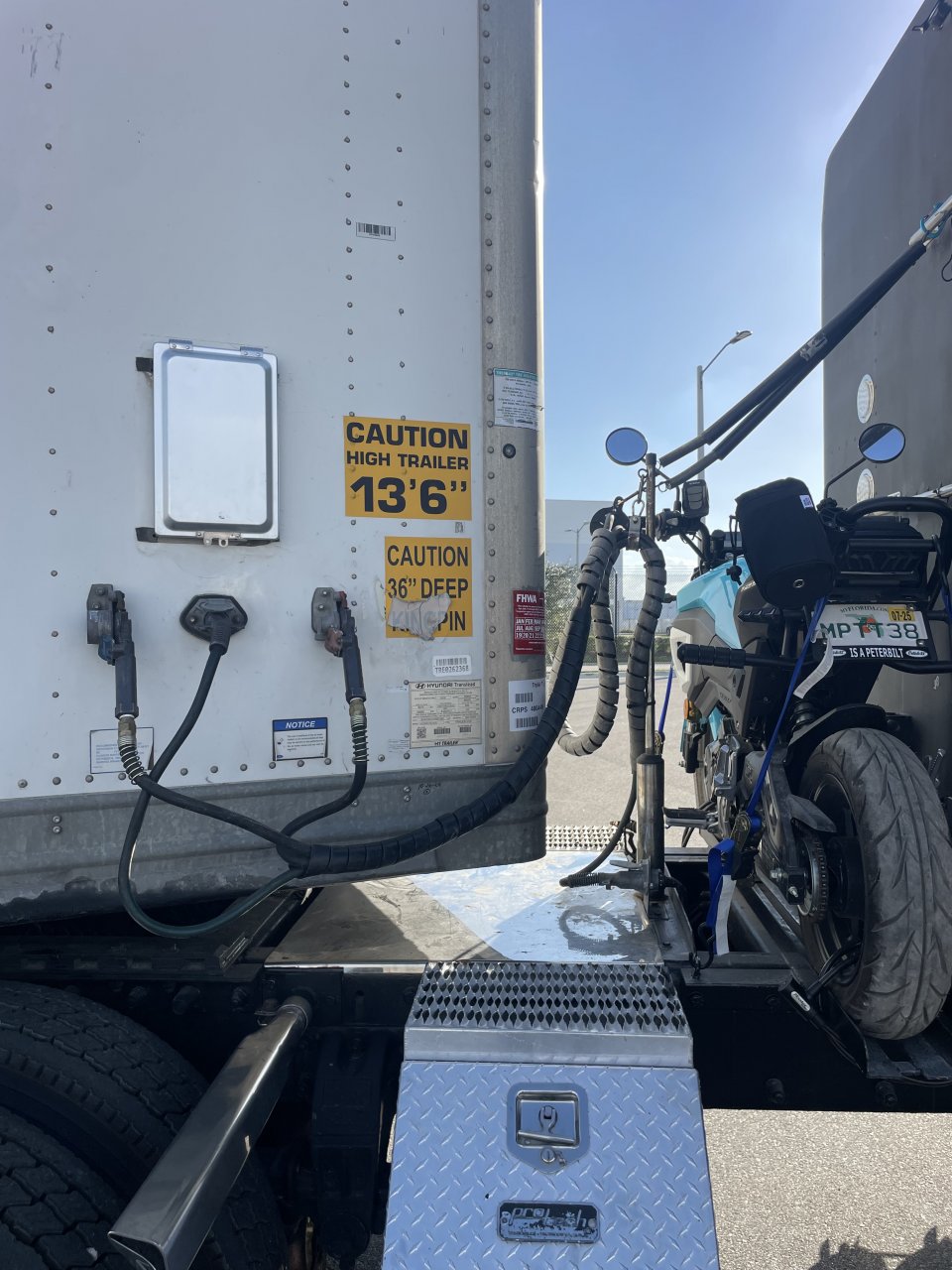

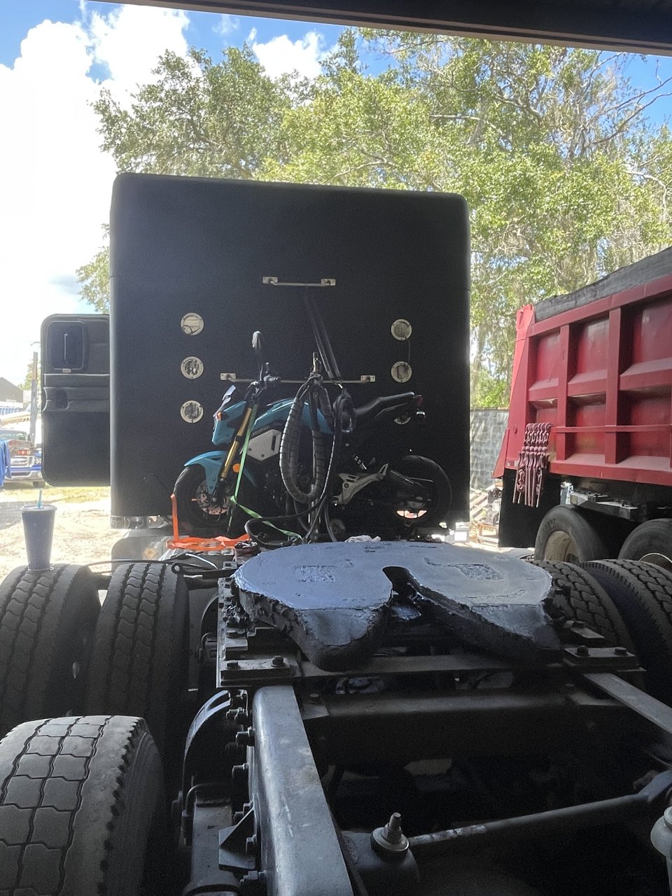

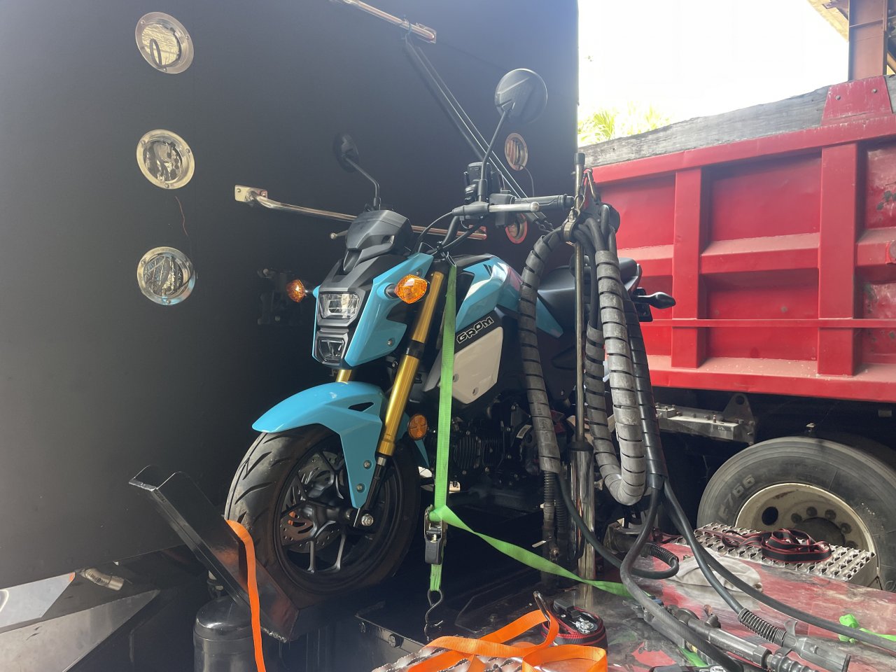

    finally had my mechanic make a mount for my grom last month. No stretch but it is an old 377 so bigger wheelbase than all the newer stuff. Takes about 5 mins to get it on or off. image.jpg

    Can you give more pics on your setup? Been looking to pull the trigger on one for a while. Do you just have a ramp on the back side and you guide it up?

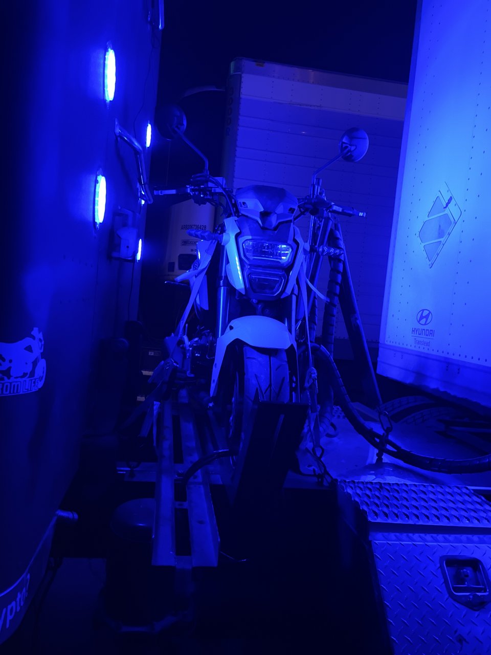

    IMG_3027.jpeg IMG_3024.jpeg IMG_2946.jpeg IMG_2947.jpeg IMG_2949.jpeg image000005.jpeg image000004.jpeg image000003.jpeg
    It’s just a bunch of angle iron, welded the ramp and the mount to more angle iron that runs along the frame and bolts to pre existing bolt holes. The ramp is what’s next to the bike. Two bolts welded below, one on each side and four fish eye hooks welded on each corner to strap it down to. Not at the truck atm but I’ll post what I have in photos for now

    What bike is that?^^^

    Honda Grom
