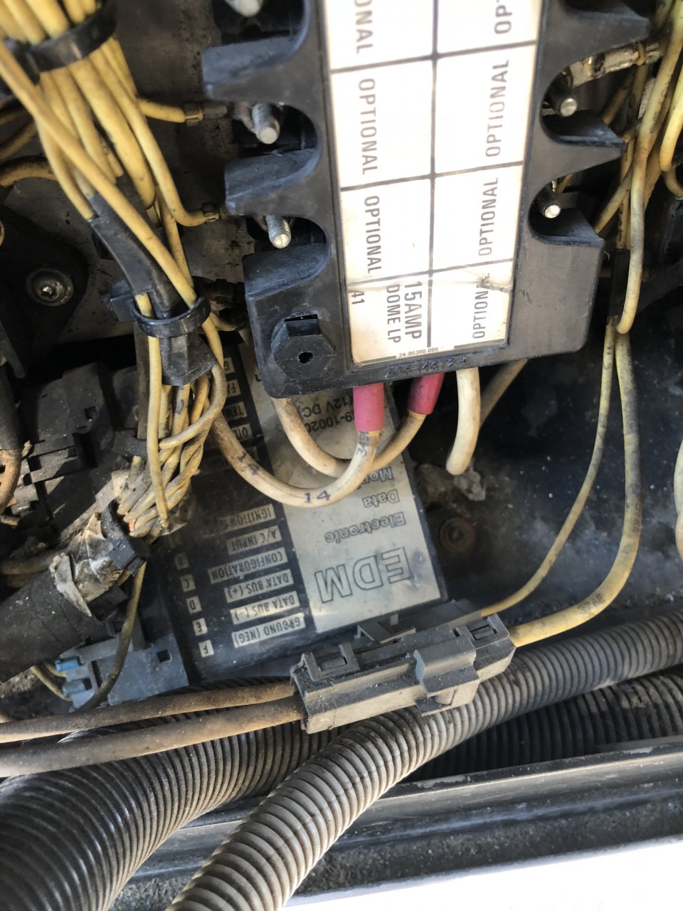

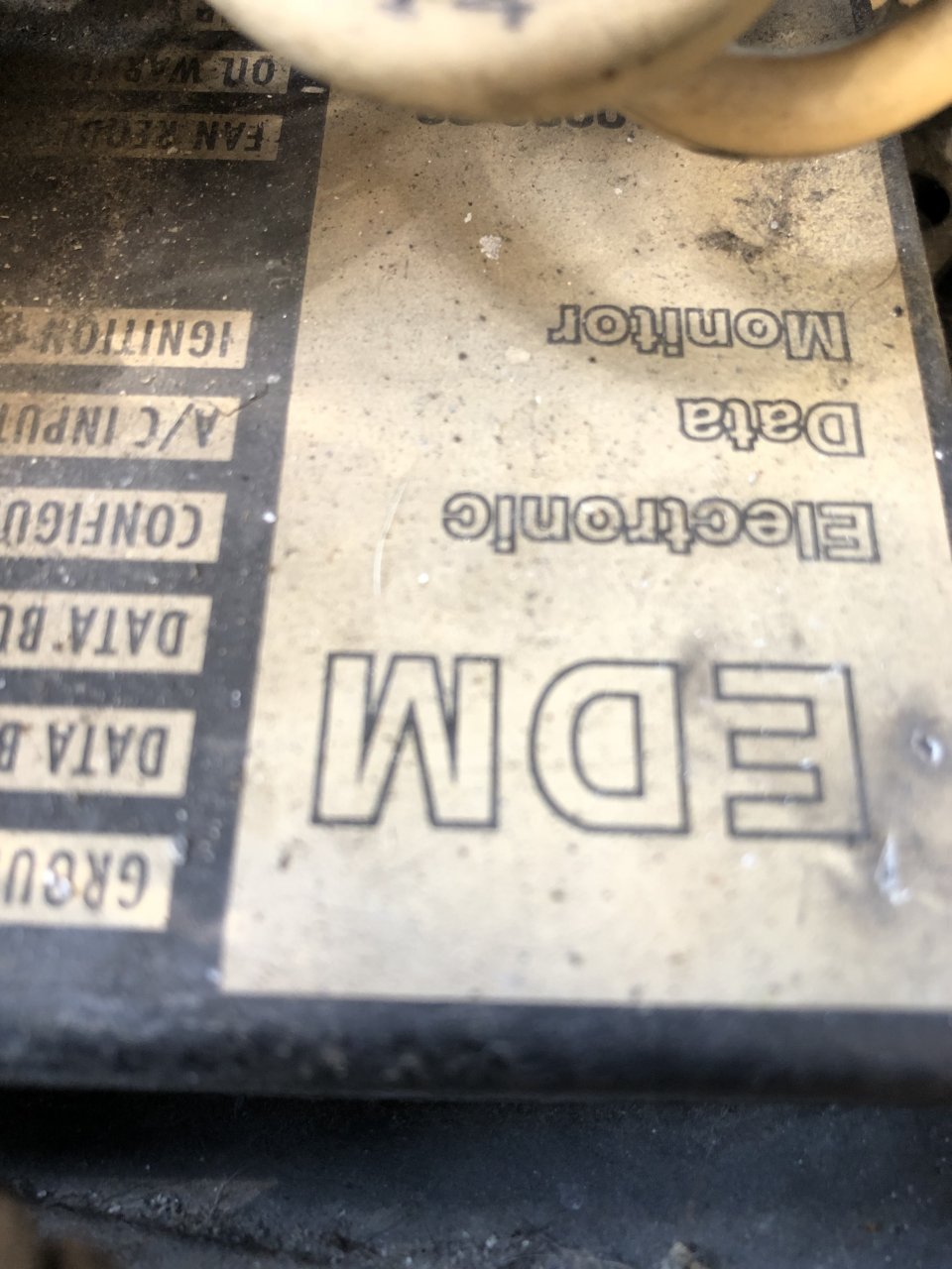

    82E23BED-78EA-4ADC-B1FA-D075287278D7.jpeg 4036BBB0-B71D-43DD-917A-90A6D65F9C23.jpeg
    . Do you know what this is for? Sits in bottom of fuse panel EDM electronic data monitor

    Check this out also do your wipers work currently
    Rideandrepair Thanks this.

    Very good info will read all now. Wipers work fine. Don’t know about while Truck was dead though. I see it controls fan switch already have had problems with it . Great info I’ll read it and get educated. I have 1 bad wire to edm hasn’t broken yet just green has been damaged . Will fix anyway need to know if this thing can shut me down or just communicates info etc . Great info been trying to find out what it does . Thanks. I gave up trying to fix yellow check engine bulb looks like sealed cluster .tiny bulbs look to be soldered in. Don’t think I’m throwing codes anyway . Got to be ground.Trying to avoid Tow or shutdown on way home to Michigan Everything’s closed down here in La.

    I'm in Colorado if you coming this way. No I don't think it can shut you down. If it's a ignition problem the wipers won't work when it happens If it's ecm related all lights and in cab will work fine it just won't fire up
