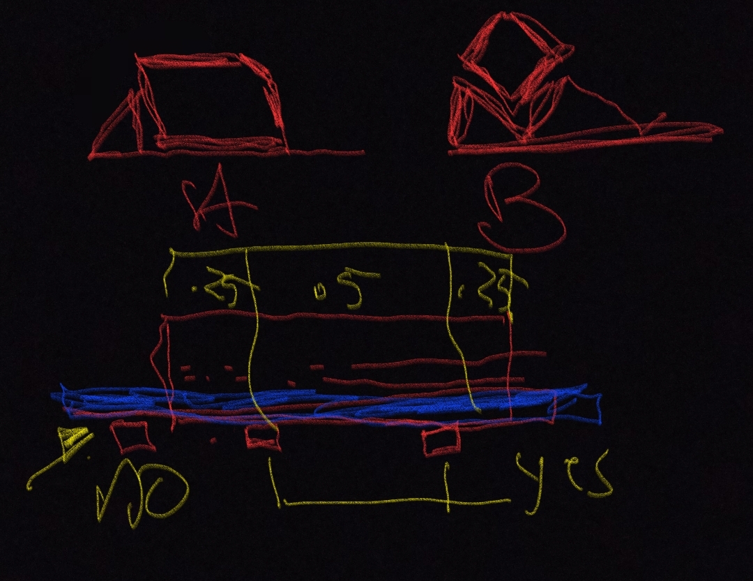

  8. skallagrime
    skallagrime Road Train Member
    3,855
    9,928
    Apr 10, 2012
    Indiana
    Brand new just means you havent found its weak bits :p
    Which rack style do you have? (See pic)
    Also, for the racks, any rack placed on the outside of the coils edge is doing more damage than good.
    For a 2 rack setup , always distribute them as close as possible 1/4 of the coils width in from their edges, this gives the most even weight distribition and even if your dunnage breaks, theres no way for the coil to fall down to the deck (see lower part of drawing)
