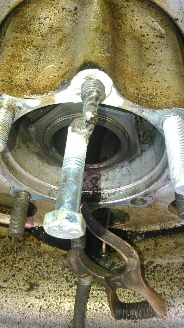

  5. BoxCarKidd
    BoxCarKidd Road Train Member
    4,562
    6,648
    Aug 26, 2014
    Like this after someone else broke off an easy out.

    if a pair of vice grips does not get them out i always go straight to welding a nut on, then if still stubborn i use a impact with very quick bursts of the trigger has always worked very well for me, if they are below the surface i just build up tack welds till i get it high enough to stick a nut over and weld it to the tack welds.
