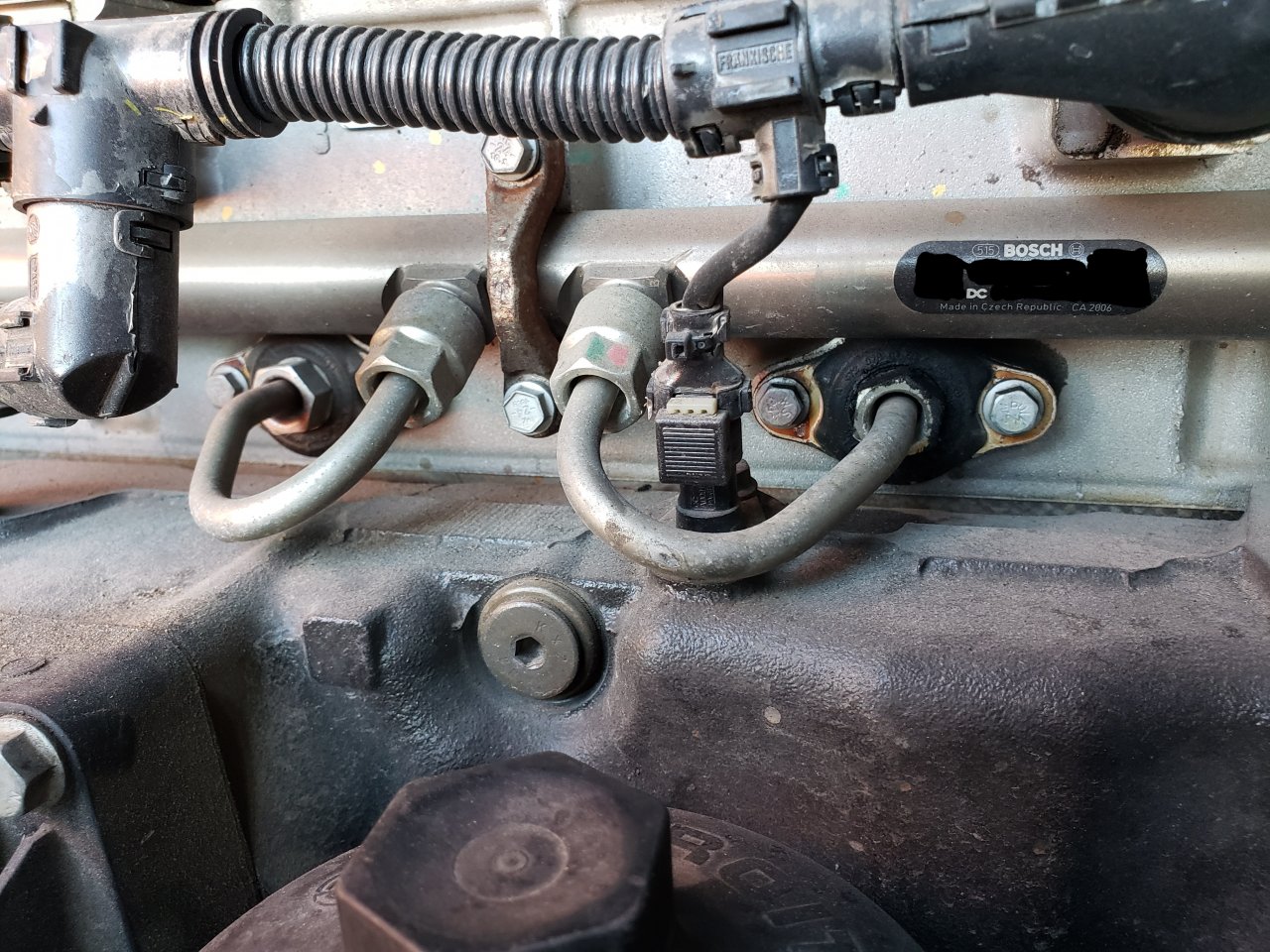

    add 1 clue
    1 day sitting, fuel still in davco, same level, no visible leaks. tried the hand pump built in fuel filter primer, no resistance at all, loosey goosey. pumped it stiff, started right up, no hiccups or stalling out. losing prime somewhere. bubbles in davco coming in on input side from somewhere upstream. how to tell where?
  8. shatteredsquare
    shatteredsquare Road Train Member
    1,407
    1,841
    May 23, 2014
    middle dirt
    add 2 clues
    1. lookie here
    2. tripac running, fuel in davco gone, filter primer loose af. tripac shut off, filter primer fills the davco back up. filter primer making bubbles in davco. davco full, primer tight, easy start.
    injector seal! wonder if warranty, factory stock untouched at ~370k miles
