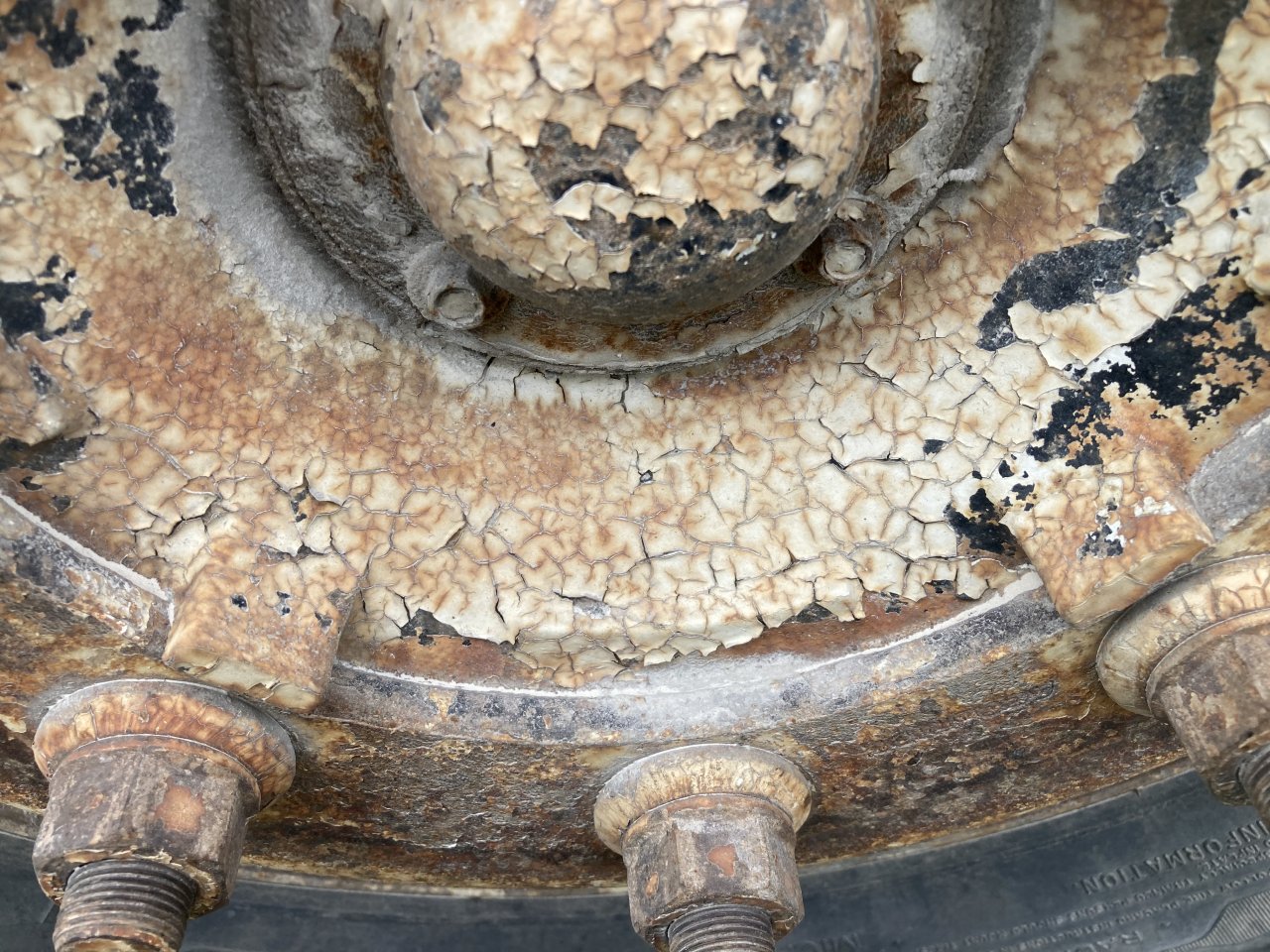

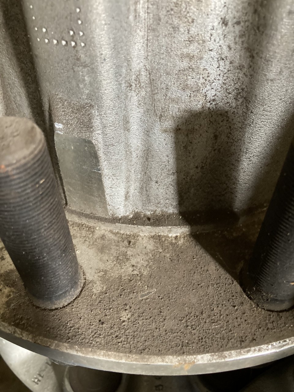

    If your wanting to change a 95 it’s pretty likely you can change the studs and nuts and keep the rest. If your hubs have the centering bosses on the hubs that will catch the pilot hole in the rim there are probably m22 studs out there that will fit
    EE6A32E4-502A-4CC2-89B4-B323991BD490.jpeg 1A1CE824-8C40-4BC1-A69E-C6B51CB48385.jpeg
    I have changed several truck tractors from the 90s with standard parts. But they must have supports like in the pictures or it won’t work
    Gambino1994 and spsauerland Thank this.

    Trouble is around here that they are usually corroded away at centering pads. Loaded con-met hubs are actually not bad price wise.
    jamespmack and W923 Thank this.
  9. Gambino1994
    Gambino1994 Light Load Member
    187
    103
    Jan 22, 2009
    causing a situation
    Yup my hubs have them smooth centering bosses on them. I only ask because a parts guy was unsure of my setup when I bought new drums, an old parts guy said my brake drum might work on either style wheel. I know the stud holes in my drums are quite a bit bigger than the budd studs in the hubs which makes me unsure about the drums being correct. Never had a problem in six years tho, but nobody touches my wheels/tires/brakes except me
    W923 Thanks this.
  10. W923
    W923 Road Train Member
    1,428
    4,426
    Feb 28, 2022
    That sounds about right.
    The holes in the drums are typically pretty oversized even for hp studs. Some apear to possibly only be cast or punched and not drilled/machined. Anything goes with the chicoms.
    If you have the support bosses I would probably see how they fit a hp rim and if good knock out one stud to measure where it goes in the hub
