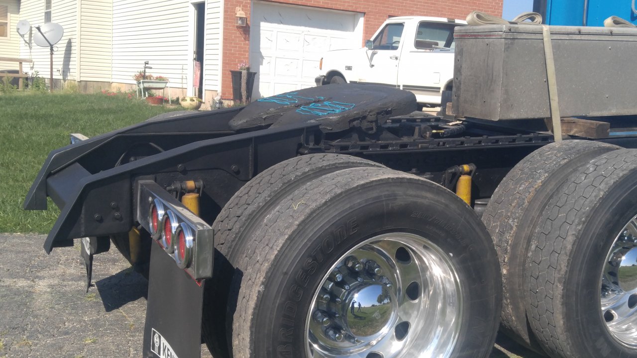

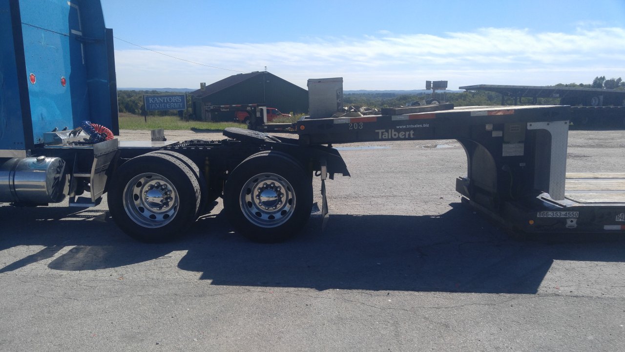

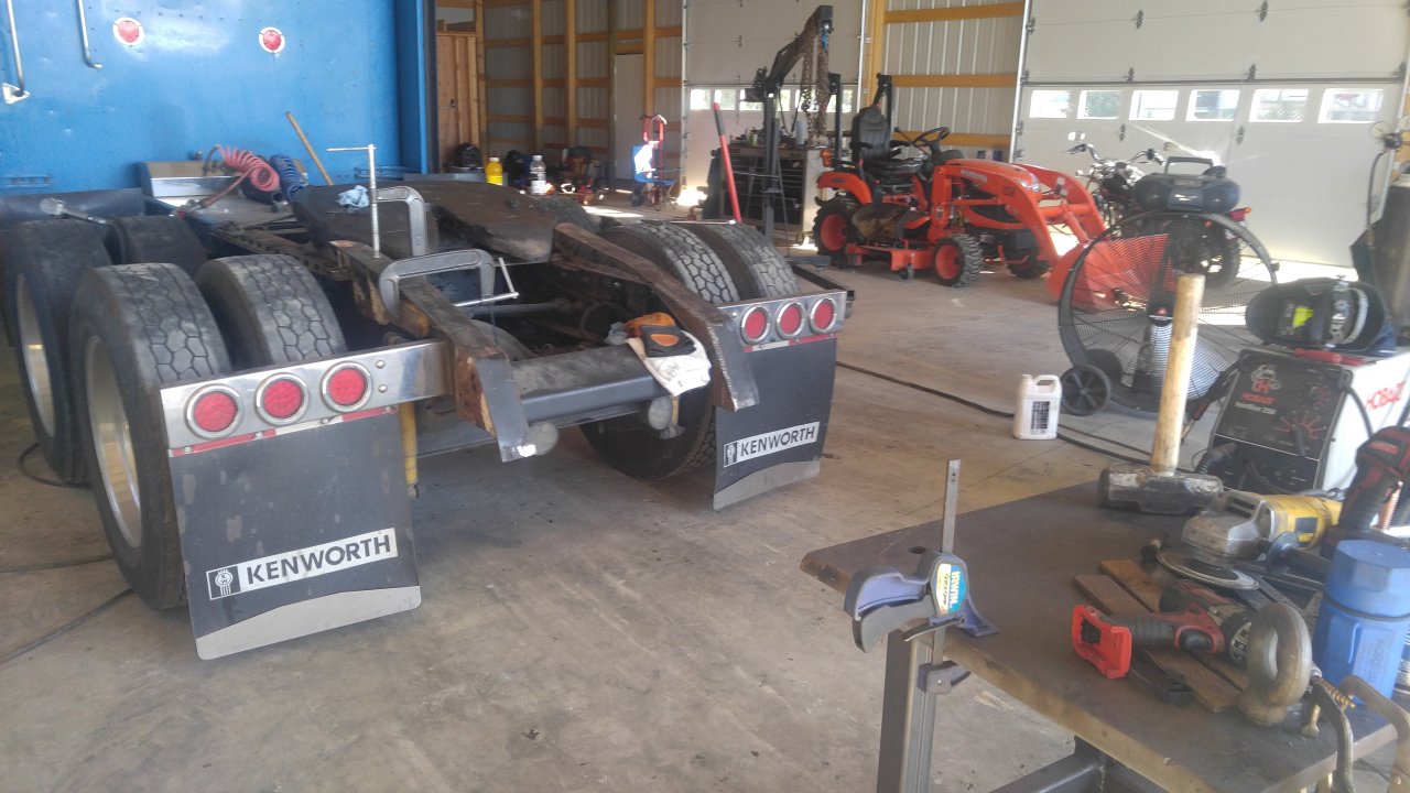

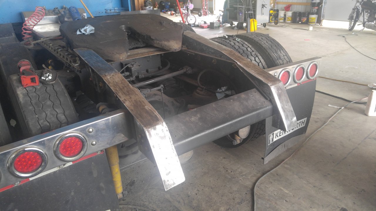

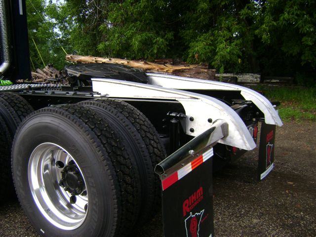

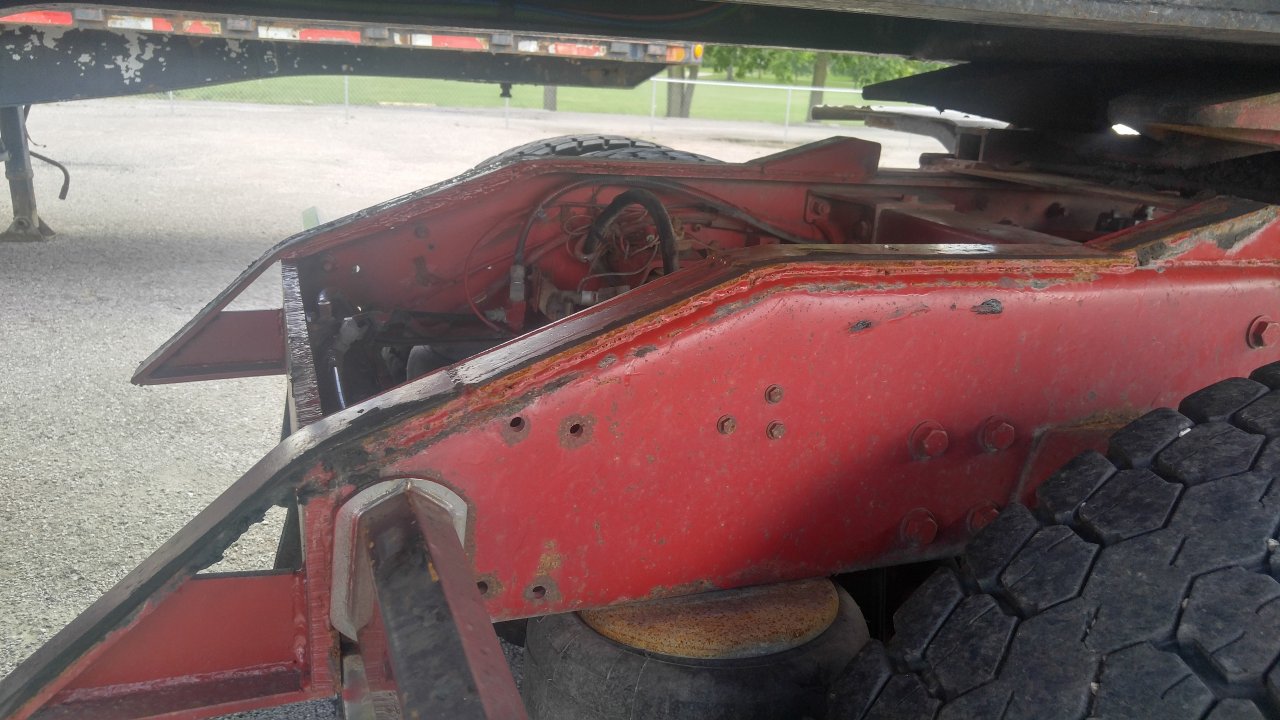

    Heres how a friend of mine done his on his old 359, its ok for local stuff around the farm and such. I didnt like welding to the frame though. No big deal on an old back up truck i guess.....i built bolt ons mostly from some scrap steel laying around. 0923160952.jpg 0911161423_HDR.jpg 0911161422a.jpg 0925161528.jpg 0924161356a.jpg 0926161119a.jpg

    Sorry, my pics got wayyyy out of order. I dont know what the hell happened. My trucks is blue, friends is red...you got the picture. Lol

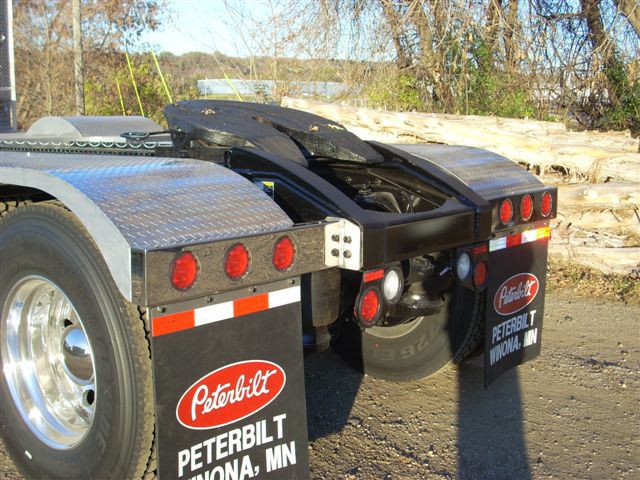

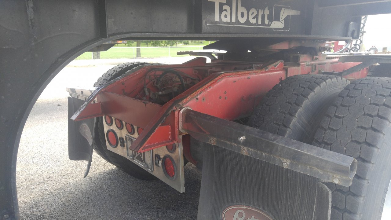

    Here's some I ran across online once when I was looking for something else, I have little need for them but I thought these looked nice so I save the pictures.
