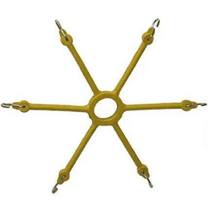

  3. xsetra
    xsetra Road Train Member
    5,199
    7,151
    Aug 21, 2011
    They sell those octopus looking chain keepers in most cold weather truckstops. I use 3-12" on each chain. upload_2024-4-7_16-34-42.png
  4. OlegMel
    OlegMel Medium Load Member
    617
    1,049
    Apr 8, 2023
    The smallest ones. 10”’or so. Make sure to retighten them as soon as you get a chance. Also place bungees so they won’t bite into the tire. Hook facing away from direction that tire rotates

  8. snowwy
    snowwy Road Train Member
    20,618
    13,339
    Jul 6, 2009
    21 inch bungees. The rims are 22.5 inches. Or 24.5 if the case may be.
    Tighten them as good as you can. I drove a few feet and retightened.
    Bungees not needed then.

  10. skallagrime
    skallagrime Road Train Member
    3,855
    9,929
    Apr 10, 2012
    Indiana
    The natural rubber does bettER in cold, retains more stretchyness than the epdm bungees, if in the north, stick with natural rubber, for 100 % south, epdm holds up better in uv though
