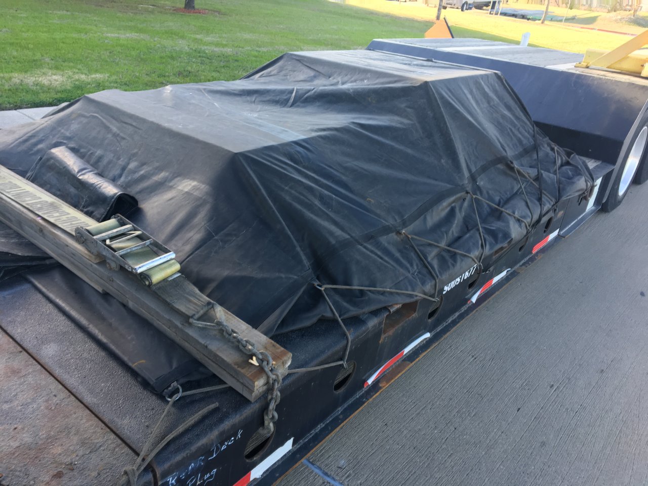

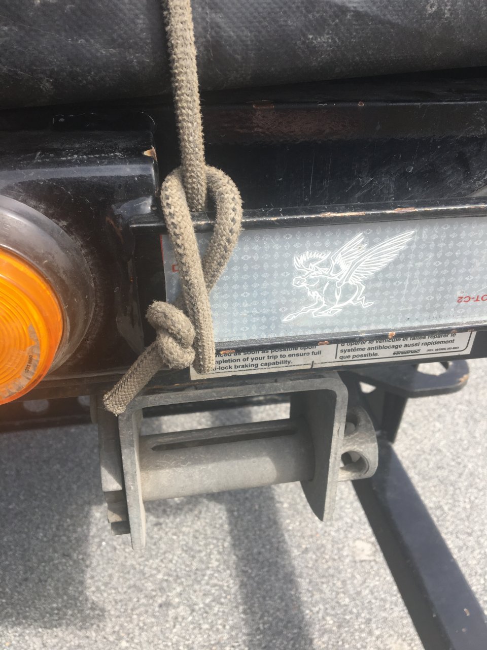

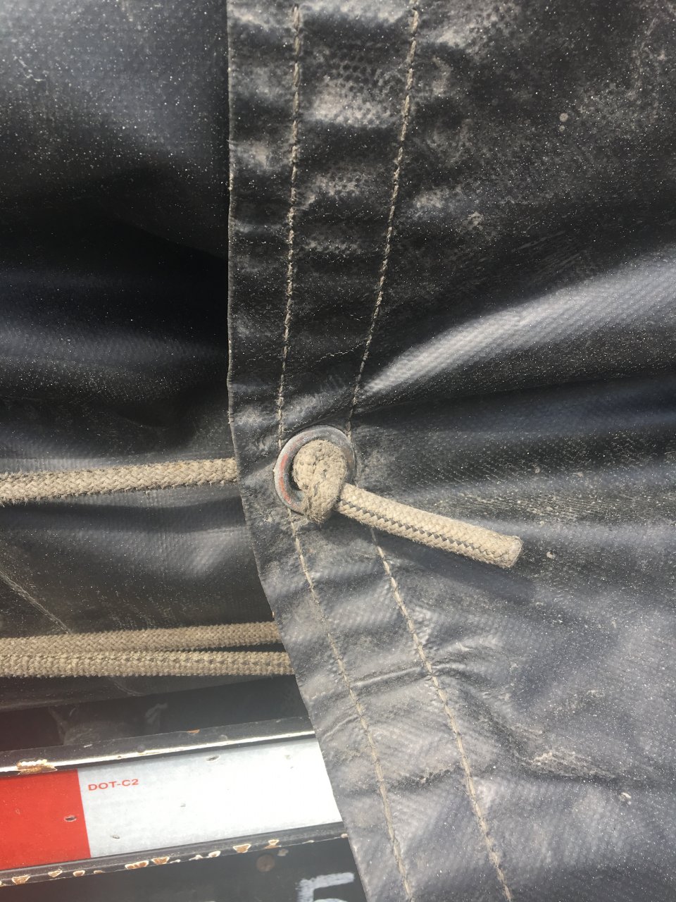

    It’s fastest if you just leave the rope threaded through the d rings when you roll up the tarp. Then you tie on end off and hook and stretch as you go down the trailer. I use the simplest knots. They hold and untie well with bungee rope.

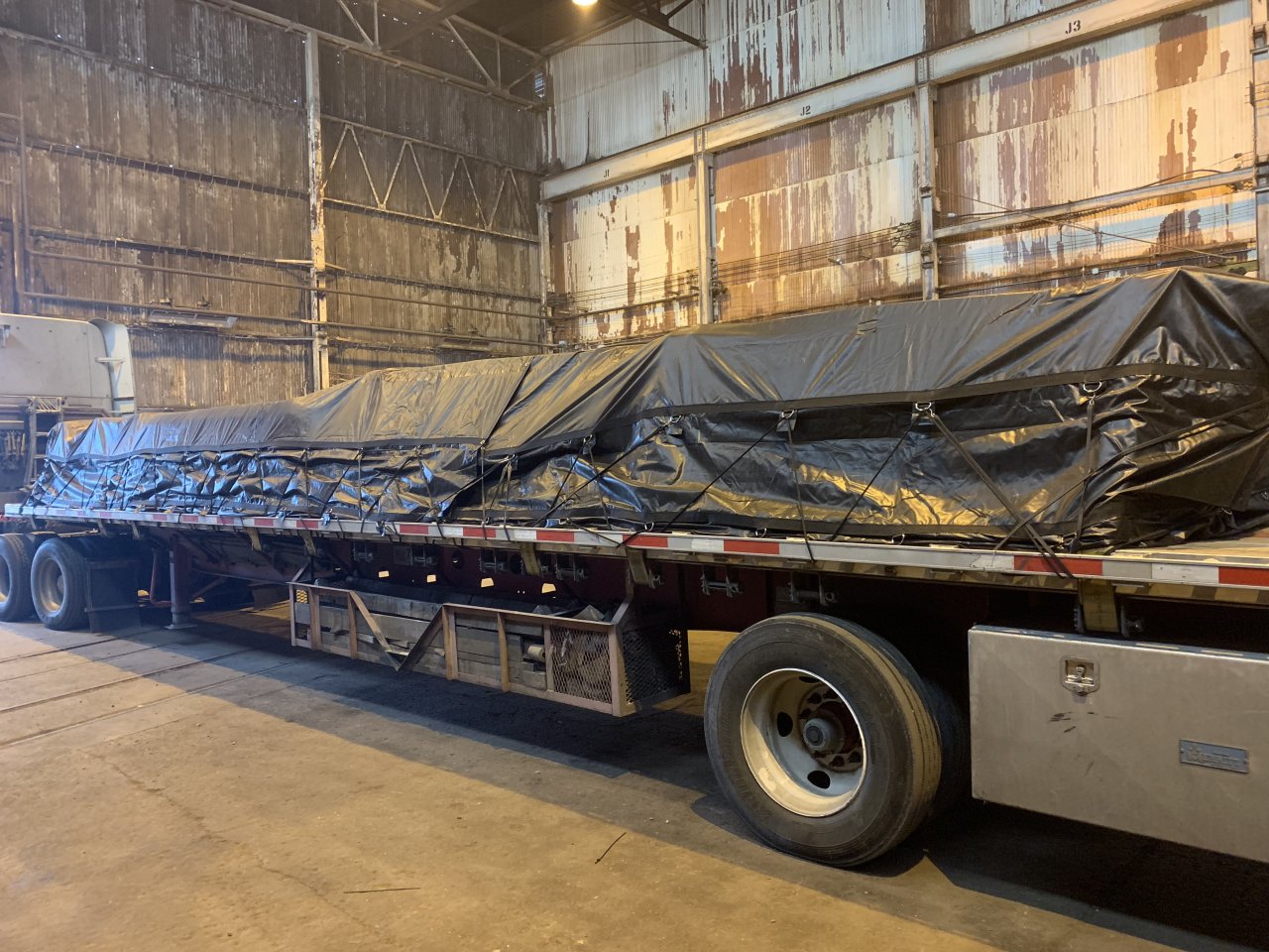

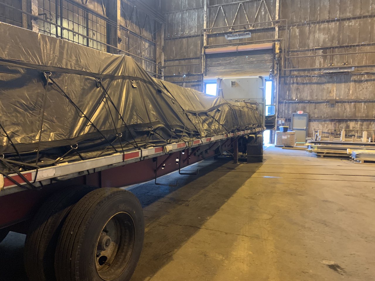

    I try to keep the tarp inside the tub rail on the deck to keep air from rushing in. Also I don’t know the thickness of their shock cord but the 3/8 I linked I use 30 ft section for a 26ft long tarp. It works for me. If the D ring row is low to the rail I can do 1.5x tarp length. If it’s way up I can do all but maybe 1 D ring. I also end the shock cord with a zip tie instead of a fancy knot because I’m stupid. Also burning the ends of the shock cord works great.

    Here’s an example. It’s a bad one because I was tarping a seriously messed up load. Usually use bungees on the front and back and shock cord everywhere else.
