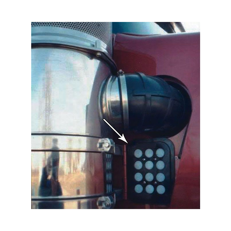

    I can't find a clear picture but the fresh air vent on your w900 is behind the right hand air filter can. That's where the filter should be. If it's not then it either never put in and it was removed. As I mentioned before, prior to 1996 filters were not a normal thing so chances are you 94 t600 came with r-12 and no filters or any place for them.

    Neither did the w9, its only on fresh air intake
    You are referring to image attached. Thats not what im talking about, recirc air filter on a kw in the cab simply isnt a thing until at least after 2006.
    You can buy the whole thing to bolt on the outside for 15 bucks, done that a few times. Ive also replaced the whole rotted out blower/evap/heater core box too. Along with every other part of the ac system hoses, drier, condenser you name it, ive done it.
    Laugh all you will at the techs not being able to find something, as i said, i went through every single ac schematic with them 3 times (once each truck) and none of em have an in cab recirculating air filter, and the outside fresh filter was never a standard item on those trucks either, always aftermarket
