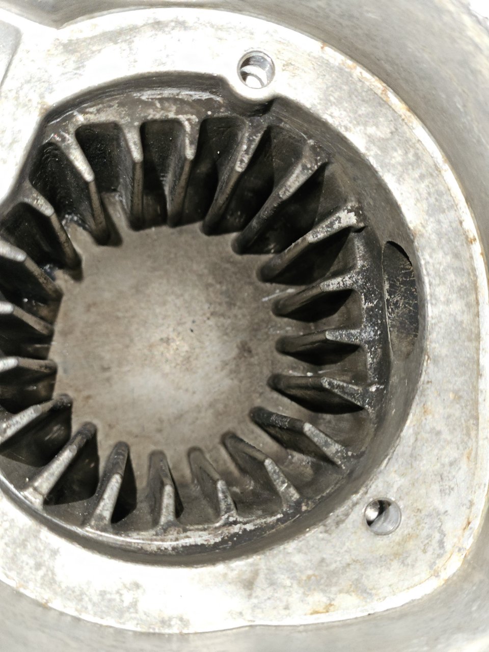

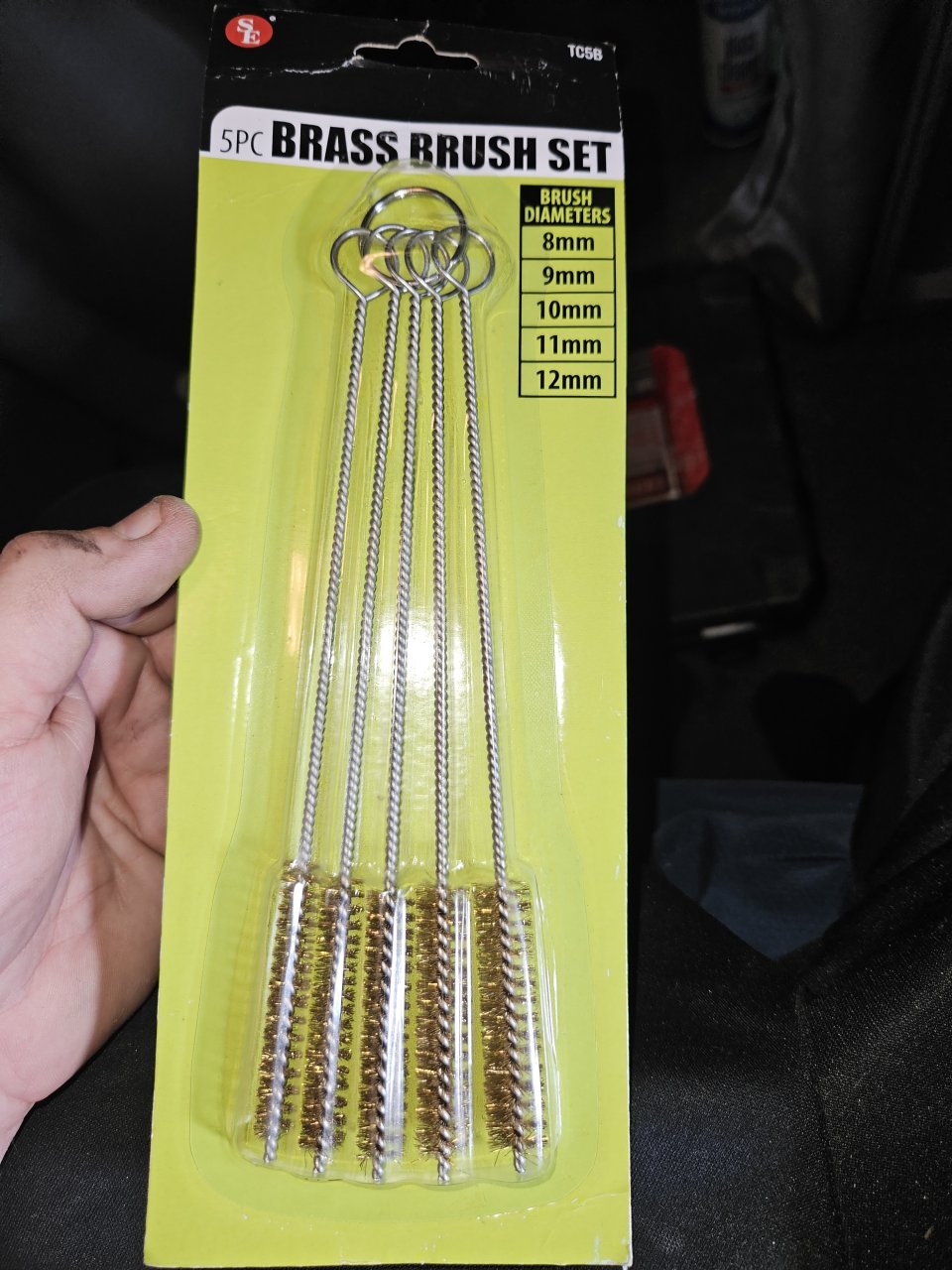

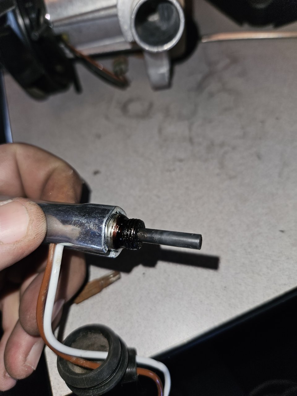

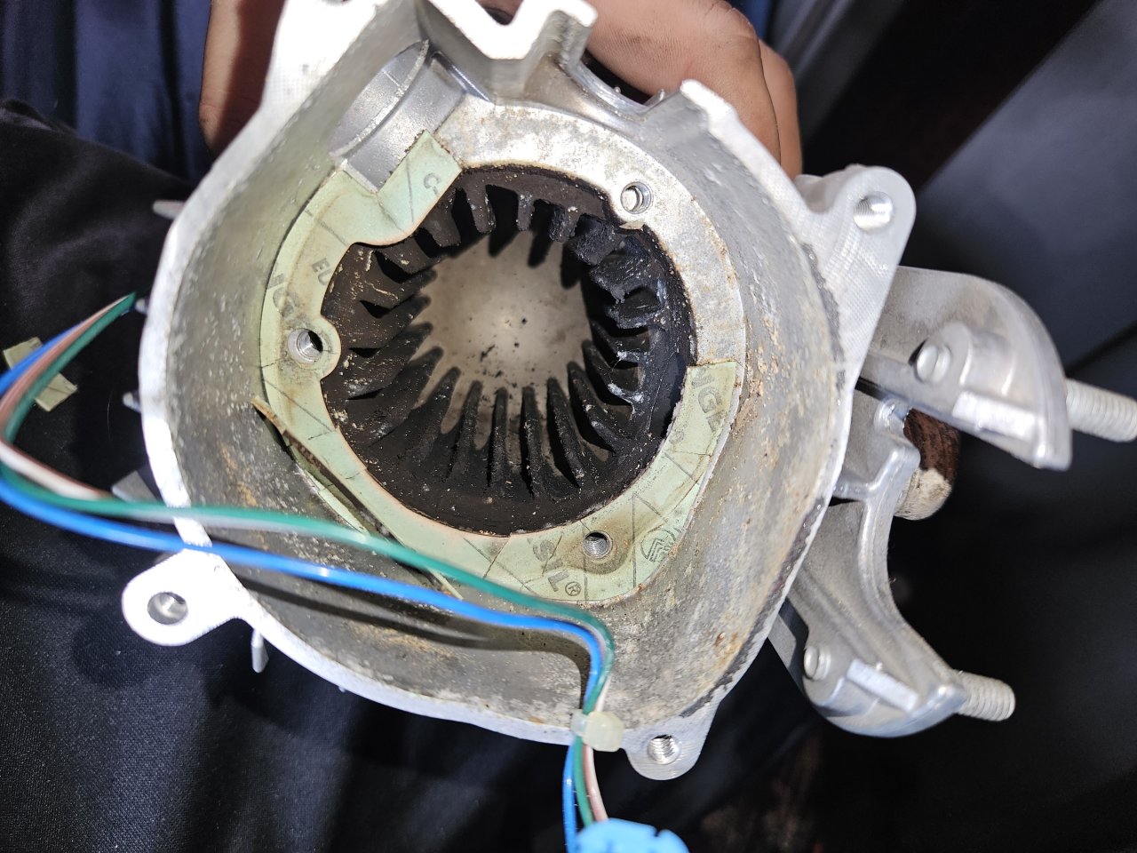

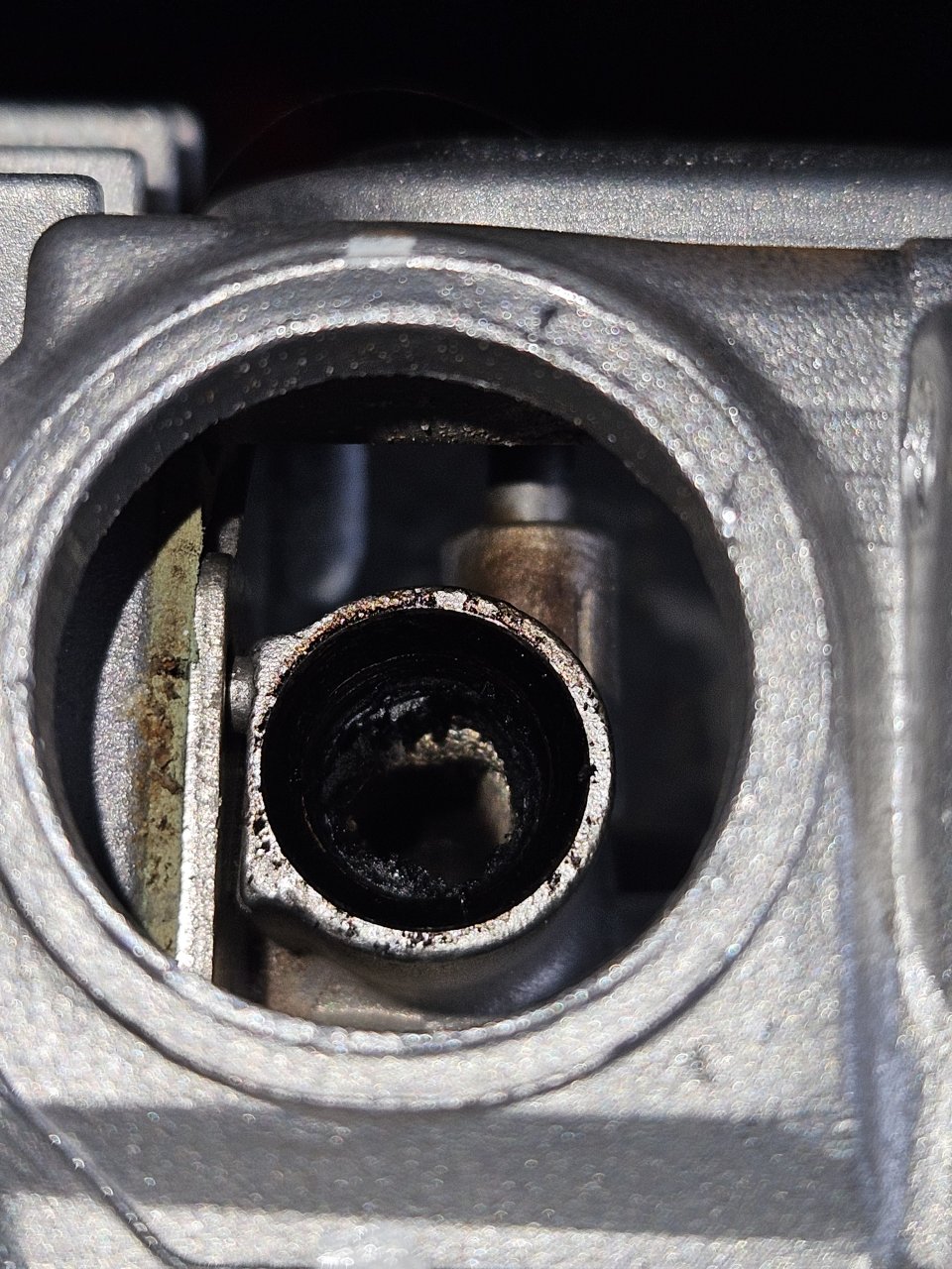

    Well I cleaned my bunk heater this weekend for the first time since buying it. Bought these little wire brushes from the tool store at Truck World in Hubbard, Ohio that fit perfectly.
    Changed out both of the gaskets, new screen, and the little fuel filter. The old green gasket crumbled like a cookie soon as grabbed it...
    Bought a new ignitor as well but just cleaned the old one up and it still works so I'll save it for the future.

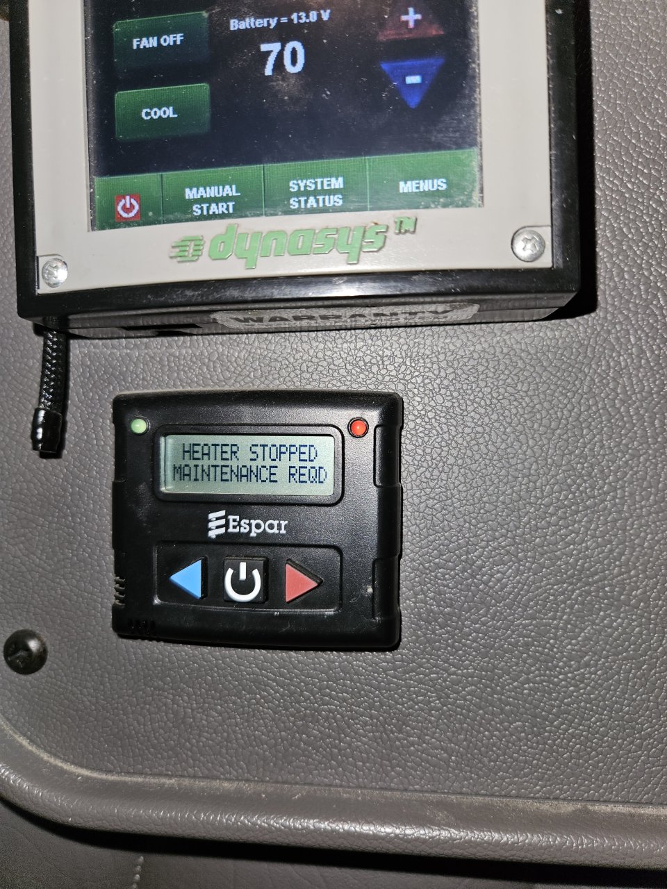

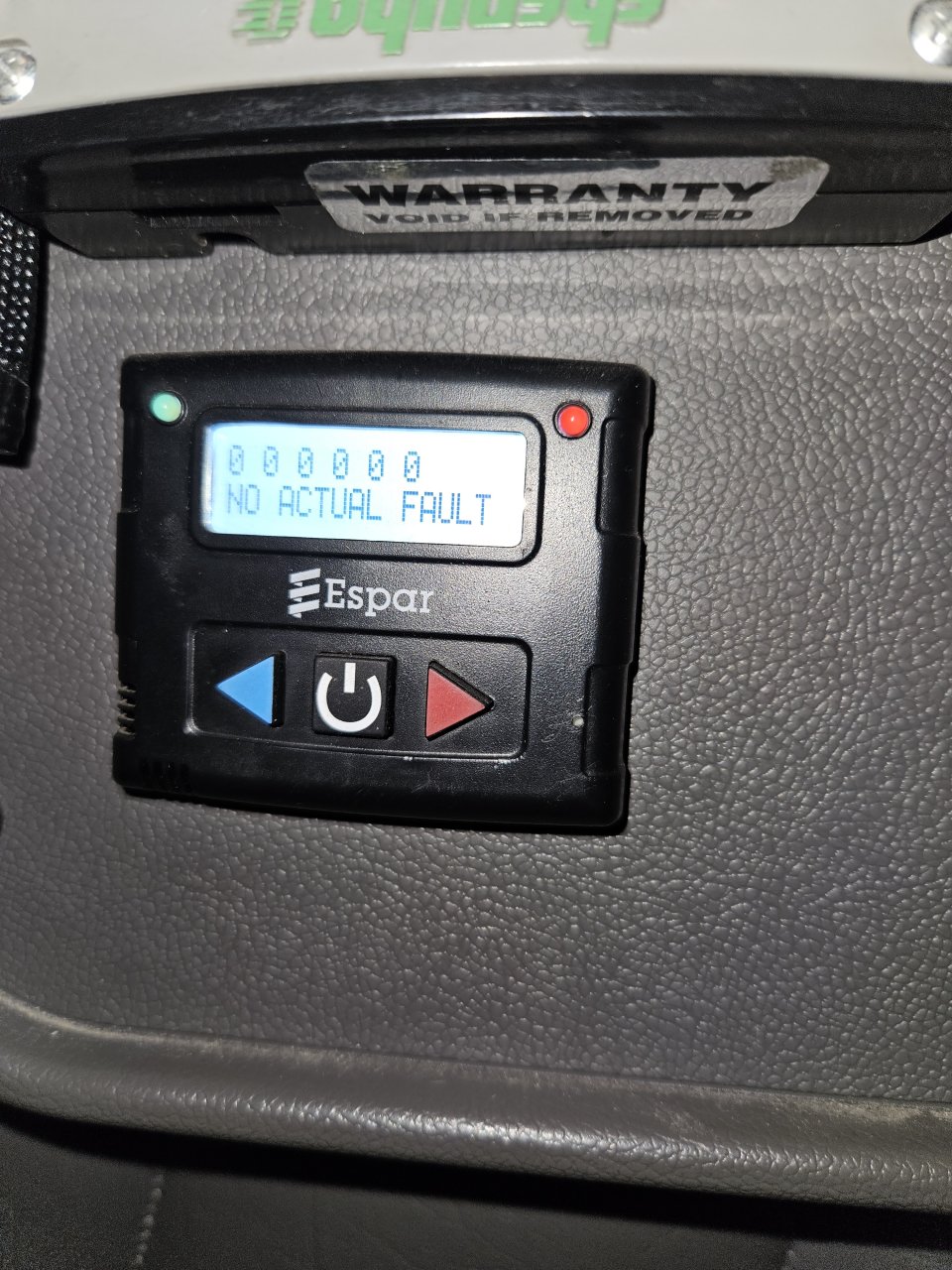

    The display screen is still showing maintenance required even though I ran the test and it shows no faults and i selected clear the message, I'm wondering why the maintenance required won't go away? Anyone know?
    Before
    After

  8. gentleroger
    gentleroger Road Train Member
    8,003
    21,908
    Jun 1, 2010
  9. skallagrime
    skallagrime Road Train Member
    3,855
    9,929
    Apr 10, 2012
    Indiana
    So another instance of you bought it but dont actually own it?
  10. gentleroger
    8,003
    21,908
    Jun 1, 2010
    Yes, if you don't own the software to tell the hardware you've done the maintenance you're up a creek. There is a way to clear it without the plug in, but I don't know what it is.
  11. kylefitzy
    kylefitzy Road Train Member
    4,755
    19,812
    Aug 12, 2007
    Kansas city,Mo
    You need to clear the runtime clock. https://www.esparofmichigan.com/man...Remote Controls/DIGI-MAX/Digi-Max 09-2013.pdf
    Vampire and JonJon78 Thank this.
