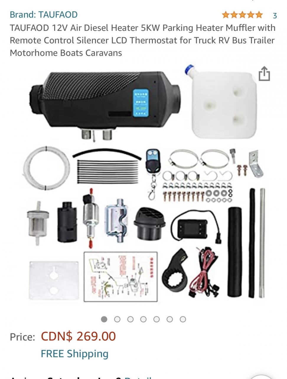

    sorry if this has been asked before.
    my bunk heater has failed and looking to get new one.
    some mechanics have recommended me the ones from amazon. ( check photos)
    cost $269 canadian.
    webasto bunk heater $1000
    has anyone used the amazon one.
    any reviews or suggestions.
    should i go with webasto or no brand.
    thank you.

    I have a Chinese one I bought for a camper. I've bench tested it and it's fine, but it's nowhere near the quality of the Espar or Webasto in your truck now.
    Fix it! It's just carbon'd up. They all do it eventually. No need to replace a good piece with a worse one just because you don't want to do the maintenance. Or have someone else fix it. It will still be cheaper.
    Oh, and you can get a Webasto for a lot less than a grand if you shop around.

    i agree although the Chinese units do work, they are lacking in quality.
    most likely your old heater is carboned up. seems like about every 2 years they need to be fully disassembled at cleaned out. new atomizer screen every year. glow pins rarely fail
    i just ordered a new espar with controller and install kit for my Peterbilt for around $750
    the espar in my mack is still going strong about 5-6 years and counting.
    the chinnese unit i bought went in a camper van, it works it dosn't get near the amount of hours as the espar but there lacking in quality plus it kinda chapped my ### that not a single advertised spec on the Chinese unit was accurate. there good for recreational applications but id stick with a quality unit in a truck.
