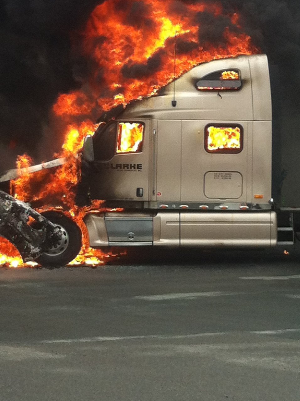

    There are MORE than enough things that can go wrong with one of these trucks, and they burn to the ground.
    I've been there. And I dont let a chance go by to let people know. Mine was an electrical short.
    I slept in it the night before, luckily it happened the next night.
    Bunk heaters are a prime spot for fire. Good quality ones have sensors and fail safes to try to prevent that. It still happens.
    And you want to trust a chinese made bunk heater?
    I have mine professionally rebuilt, the complete rebuild kit including burner pot is cheap. EVERY 2 YEARS.
    I ALSO NOW HAVE A SMOKE AND CARBON MONOXIDE ALARM.
    Pay your money, take you chances.
    My truck went from smoke to this.. in less than a minute.
