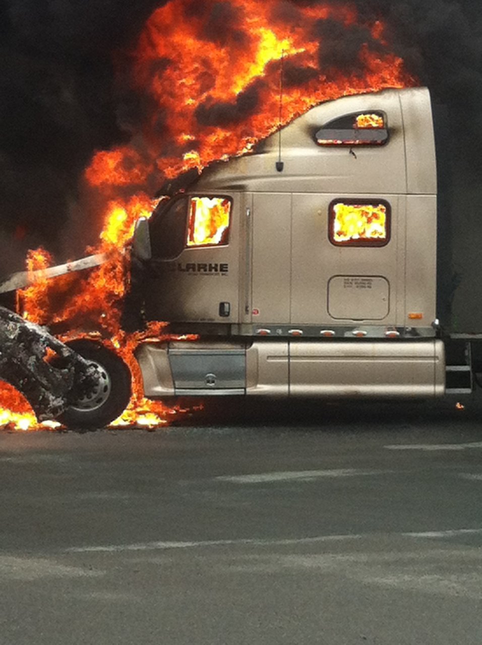

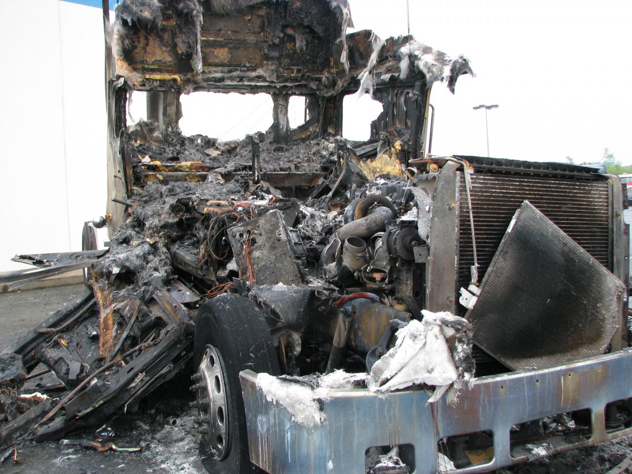

    Sorry to hear about your truck but yours was an electrical fire which 99% of the time if it is inside the cab/sleeper, it is an electrical issue.
    heaters just don’t explode, they don’t overheat unless there is a serious malfunction of the control unit (extremely rare) with many times if people don’t keep a clear area around the heater to prevent a contact fire, then a possible fire is slim slim but still possible. some of the trucks I’ve looked at to buy had them covered up with rags and one with a can of ether on the side.
    Chinese or German, they all work the exact same way, they use fuel metering from the fuel pump, which is how it controls the temperature, if there is a malfunction, it stops working unless there is a serious malfunction of the control board which is very unlikely.
