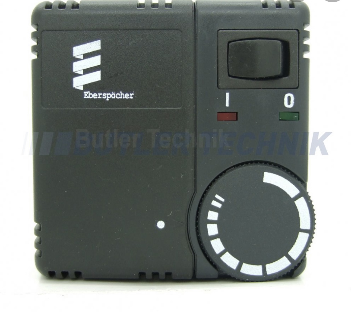

    mine was doing the same thing, double checked the grounds and it still did it, but I cancelled the low voltage shut off on it and it stays on now, my inverter has a read out though and it never drops more then 12.2v even when I leave it on for the weekend so I’m assuming there was something in the controller, but I never did anything with it

  5. -blitz-
    -blitz- Bobtail Member
    43
    17
    Apr 26, 2020
    my conroller is like below in pic..
    i really cant do anything with the settings..
  6. abyliks
    abyliks Road Train Member
    4,154
    9,795
    May 2, 2010
    ludlow MA
    It might just be programmed in there, I have the digital display
