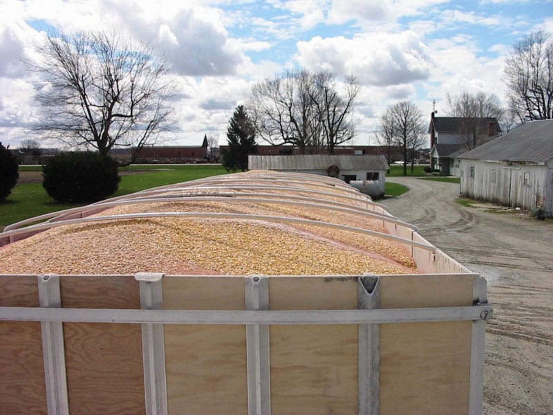

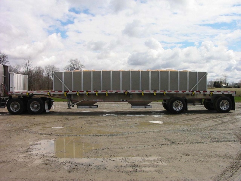

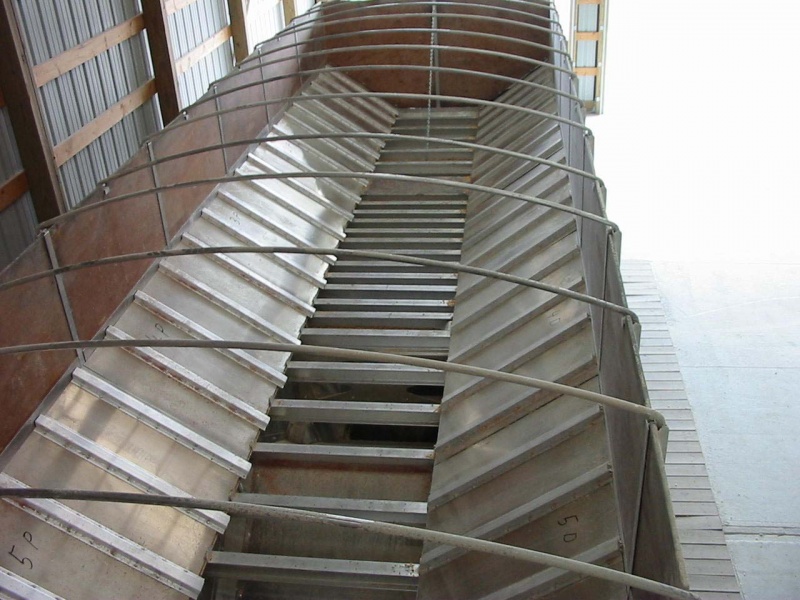

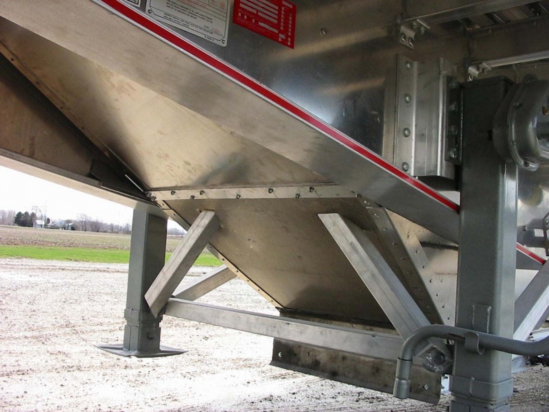

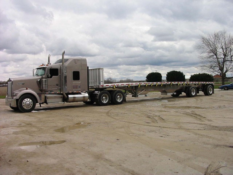

Which is why we built this trailer. Hopper freight one way and flatbed freight back.Attached Files:

That thing looks pretty darn cool, jfalk99. How long does it take to switch from flatbed to hopper and vice versa? What's the empty weight on that truck and trailer? You built that yourself? Must have some superior fabrication skills!
Well just slightly longer than a regular sidekit because it has all the grain stakes and bows in every post. The slope panels just fold down and become the floor. We've made 3 of these, the first was a combo trailer. The second was an East but since it was only 96" wide it had to be loaded full and was a pain. This was built on a new Wilson and can hold almost 63k lbs of grain. Granted not ideal for short runs but works great for the longer stuff where there is either no hopper loads back or what's there is CHEAP. Haven't used it as a hopper in a while because of the corn prices but we used to haul grain from Ohio to NC or SC and bring lumber, steel ect. back. The truck/trailer in the pic is under 32k (C15 13spd)
I don't know about the fab skills but it works.
