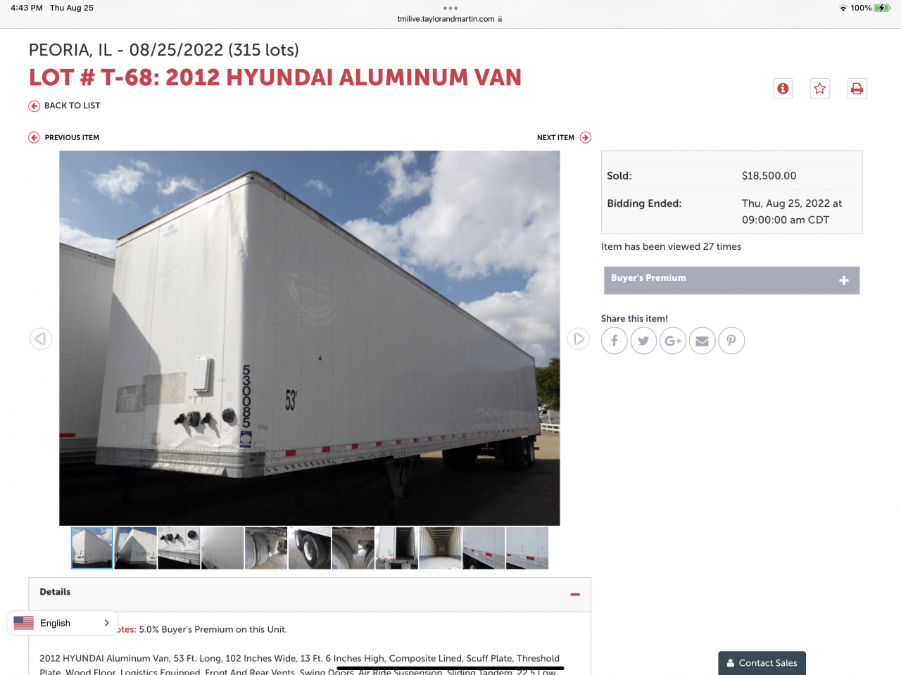

    I’ve seen a ton of dry vans at the Taylor and Martin auctions lately.
    But each auction is different.
