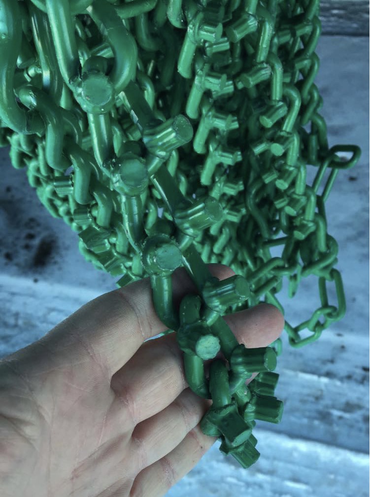

    I’m not sure what brand, my old boss bought them from a company in Bonners Ferry ID. Throw those on and you were going to go just about anywhere you wanted to go.

    I've almost bought a set like that a couple times. But the only place I chain is Colorado, and they've gotten as bad as California about throwing up the chain law unnecessarily. I'd hate to wear out those expensive chains on wet/slushy pavement!

    The most expensive chains sold, are a frigging bargain, compared to the alternatives of not having them.
    I order mine every summer, when demand is lower.
    This year wasn't a big order, still had lots of good ones left over, so it was only a $72,000 order.
    I consider that cheap, and feel like I got off easy.
    If I had to cut costs, it would not be on chains.
