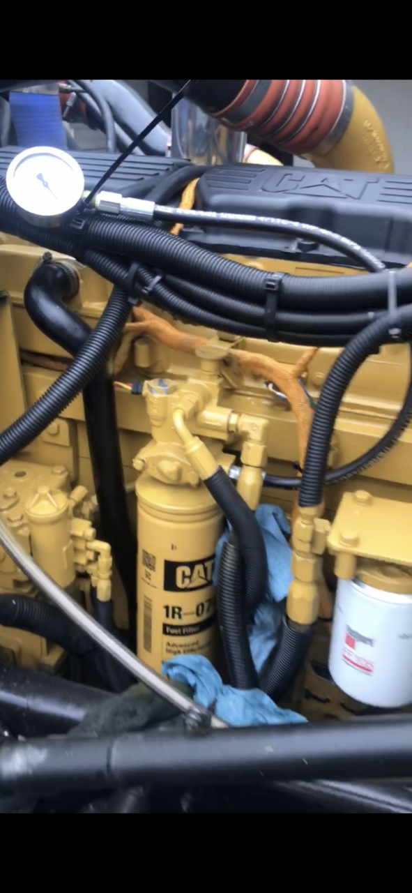

    Here’s a pic of one of my trucks I took checking fuel pressure. The gauge is lying up by the valve covers. Follow the gauge hose to my fuel test port on the filter housing.

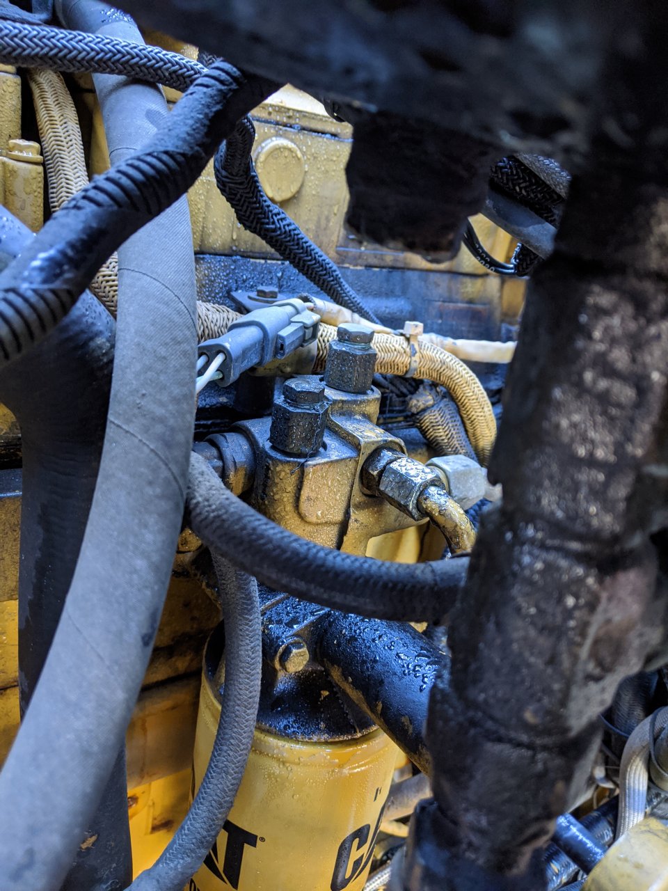

    Thanks for the info. Crazy he gets the same thing I get when I try and pull the engine codes. It says ecm not present or malfunctioned on the TIM. So I need to look behind the return line for the port to check pressure, is that correct?

    I was able to check the pressure at the correct port, video shows it all. I unplugged random sensors on the engine and the CEL didn't illuminate. Nothing registers on the rpm when cranking or running on ether. Pulled the valve cover and put a tester on the injector to see if there was any pulse. Found a video online of someone doing it, so I figured I'd give it a try. Now what?

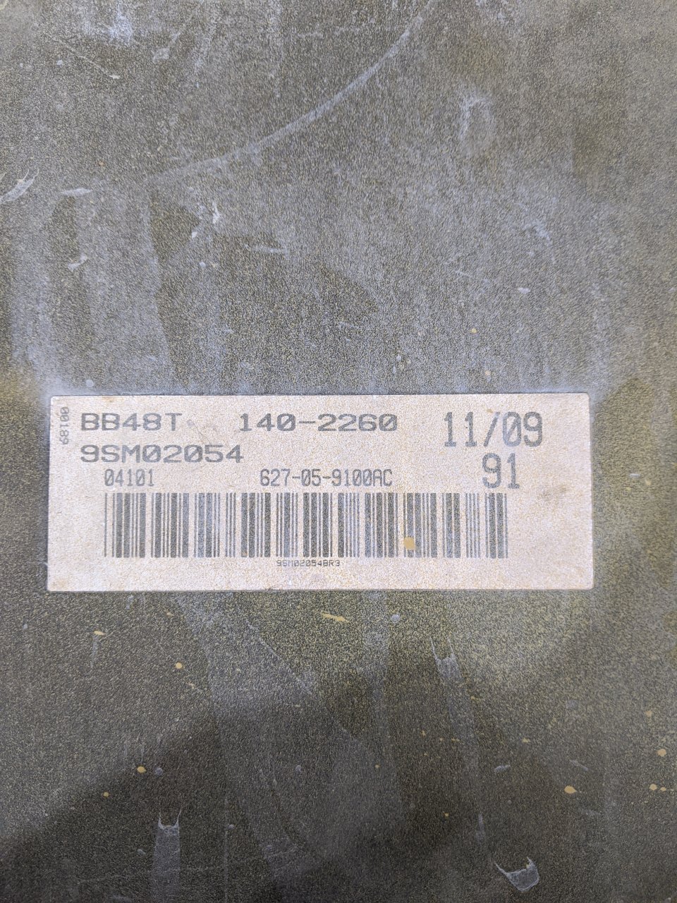

    Someone with Cat ET or test ECM time.
