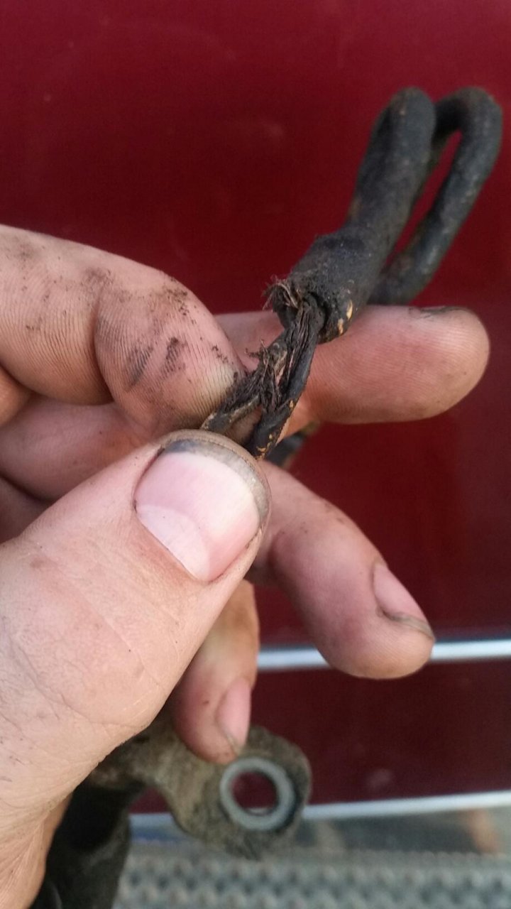

    When I fire up mine in the morning it smokes a thick white smoke. It only does it if I bump the rpm up, if I let it sit at adle then it won't. ... I fire it up and it runs fine for a minute and then starts to smoke, after it warms up it'll stop. I also do not ever get over 30 lbs of boost.
    Rebuilt motor with new head, replaced injectors, coolant temp sensor, intake sensor manifold temp and pressure sensors,fuel temp and fuel regulator, crank sensor and pigtail.
    Here was my crank sensor pigtail.... thought I found the problem when I saw this but nope......
    I've had to rewire my harness before because there was a brake in it going to the iva solenoid before, so at this point.... I am thinking a new ecm harness may solve my issue.
