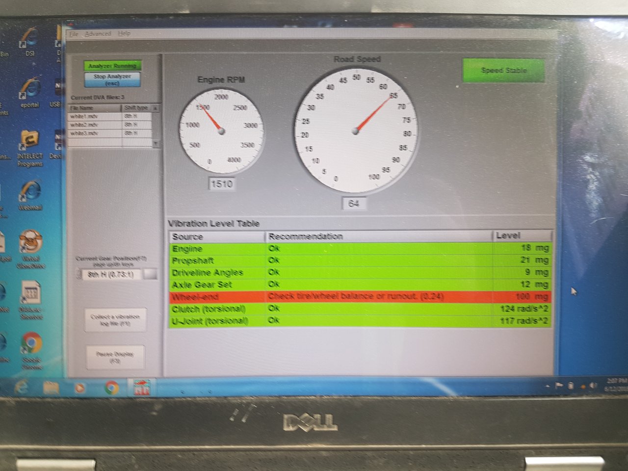

    It needs to have a DVA put on it and taken for a road test. Driveline Vibration Analyzer is made by Eaton and it is a collection of sensors that mount on the truck and based of the speed/frequency of the vibration it can figure out where it comes from. Super handy tool. I have used it to point out out of balance tires, improperly balanced driveshafts and ride height.
    Vibration complaints are the hardest to diagnose without driving the truck. The terminology of describing what is happening varies too much. Once you have experienced many different trucks with different problems it becomes way easier to diagnose.
    Also check your clutch adjustment. If there is no free play the pedal will put all of the torsional vibration into the floor and it sounds horrible.
    I attached a screen shot of my latest drive with dva. Most dealerships should have access to a DVA machine. 20180612_140740.jpg
