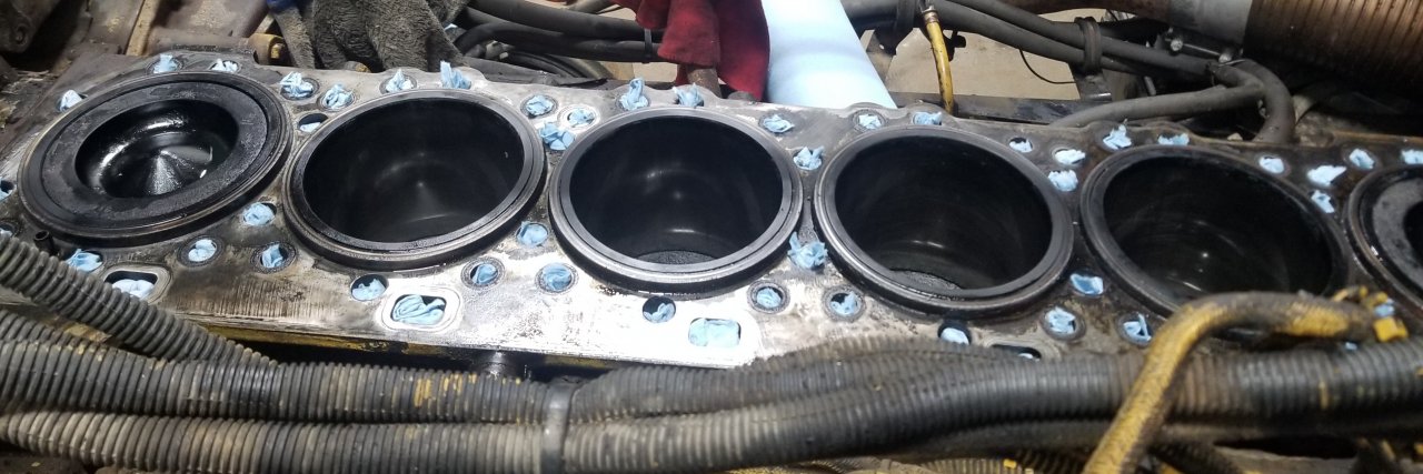

    Yeah I think those numbers are way too low. That spec of .001 to .006 seems awful wide. Think most say you need to be closer to the high side to be safe. If they are even enough you could probably buy some time with the thinner spacer plate. Might buy you a few years.

    We were getting ready to drop a liner I'm guessing cause that sure looks cracked to me.

    #1 is out of spec. Discovered the liner flange cracked

    Needs Rebuilt block needs counter bored

    That's what I will be suggesting.
