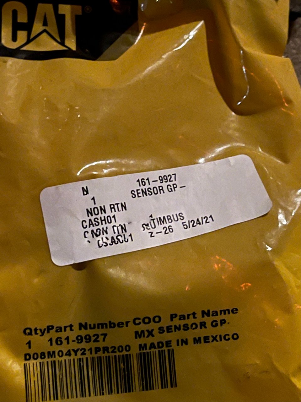

    Yes, I’ll take a pic of it when I get home.

    Fully loaded today she was pushing 80 up hills and staying with traffic no problem. Glad this is fixed. Thanks again!

    Two sensors and O-Rings.
