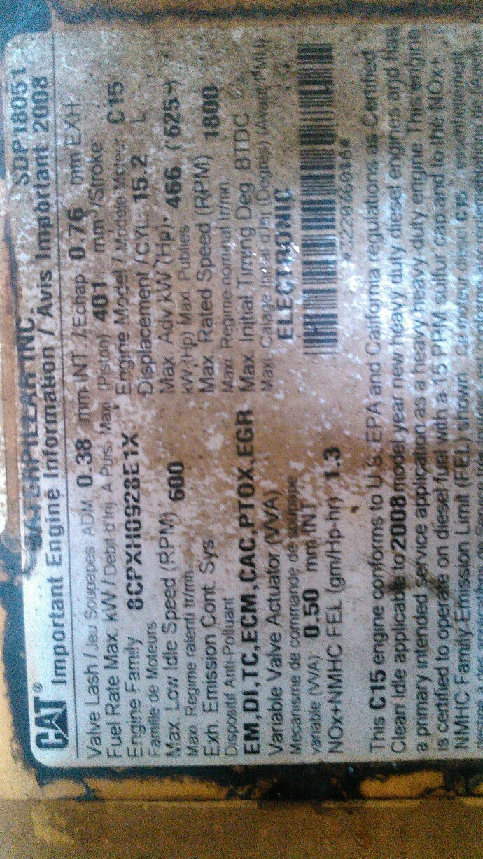

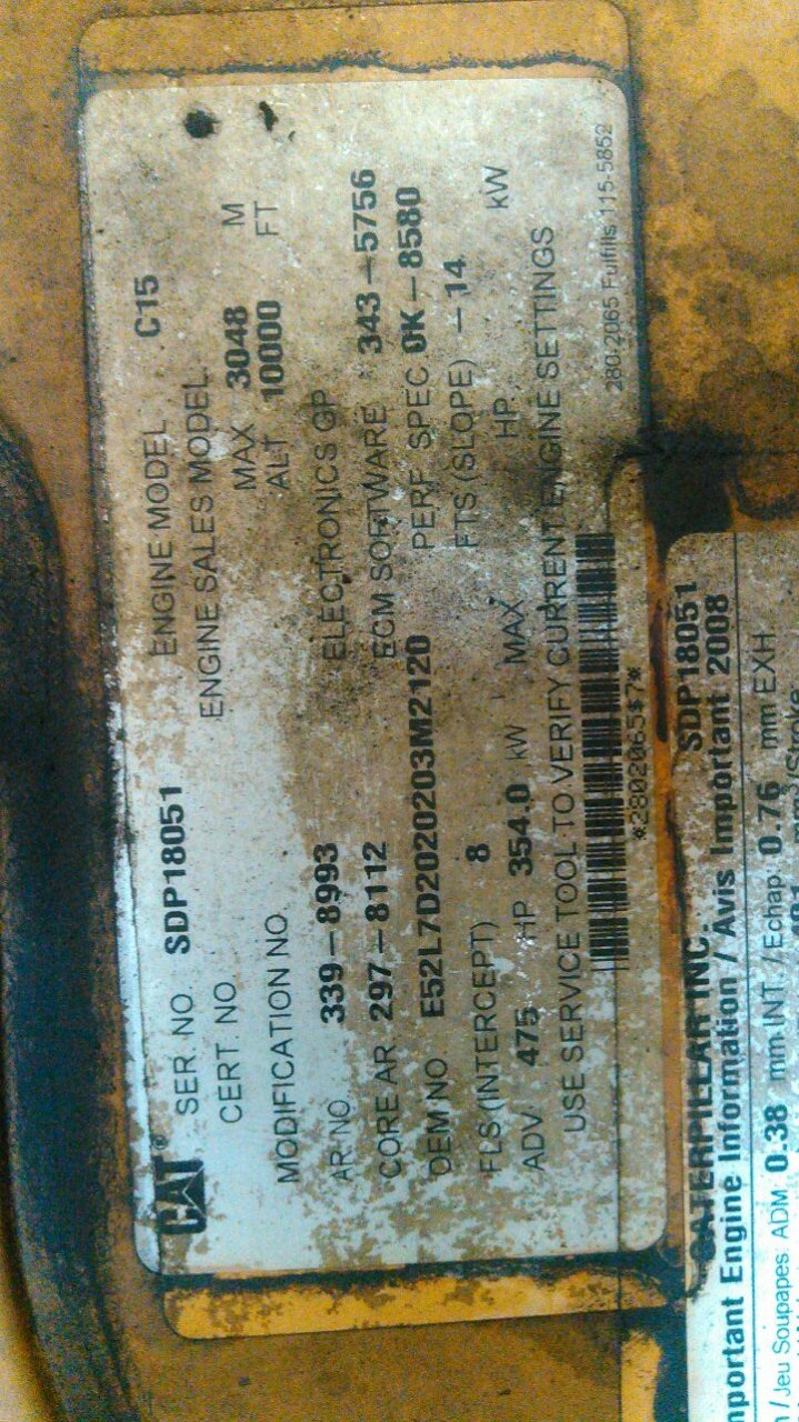

    Have a few Cats hanging around here. One has a crack in the front cover. It is in front of the idler that runs the fuel pump and air compressor. Did not thank we would need a book for a front cover job but stopped when we did not find timing marks on the gears. Would really like to pull it down and inspect before a book and front cover show up. Any info appreciated. KIMG1213.jpeg KIMG1212.jpeg
