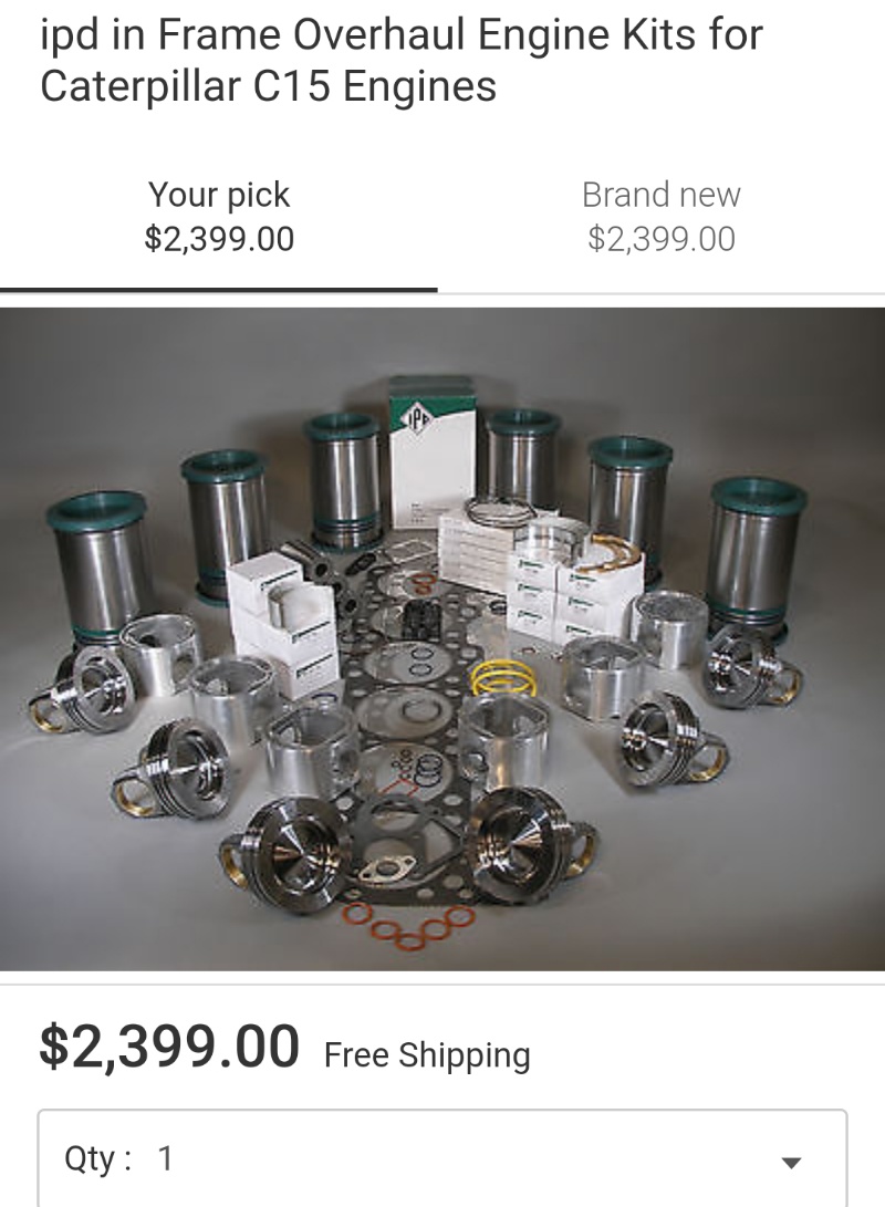

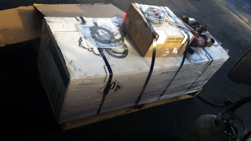

  6. IPD is an aftermarket kit
    Look into replacing your head if it's even close to 1mil in mileage.
    Items to look into while doing inframe
    Water pump replace
    Thermostats both replace
    Check air to air (clean out, pressure test)
    Radiator clean it or replace it
    Clutch fan check it or rebuild kit
    Fuel lines to motor replace
    Fuel lines from tanks replace
    Change radiator upper and lower hoses
    Heater hoses to bunk and cab
    *******Important********
    Replace hoses behind turbos while they are off.
    Check liners if you need them couterbored do it before Inframe as well as getting correct shims for liners.
    I know I'm forgetting something stuff I just did this on a MXS motor.
    So any questions ask away.
