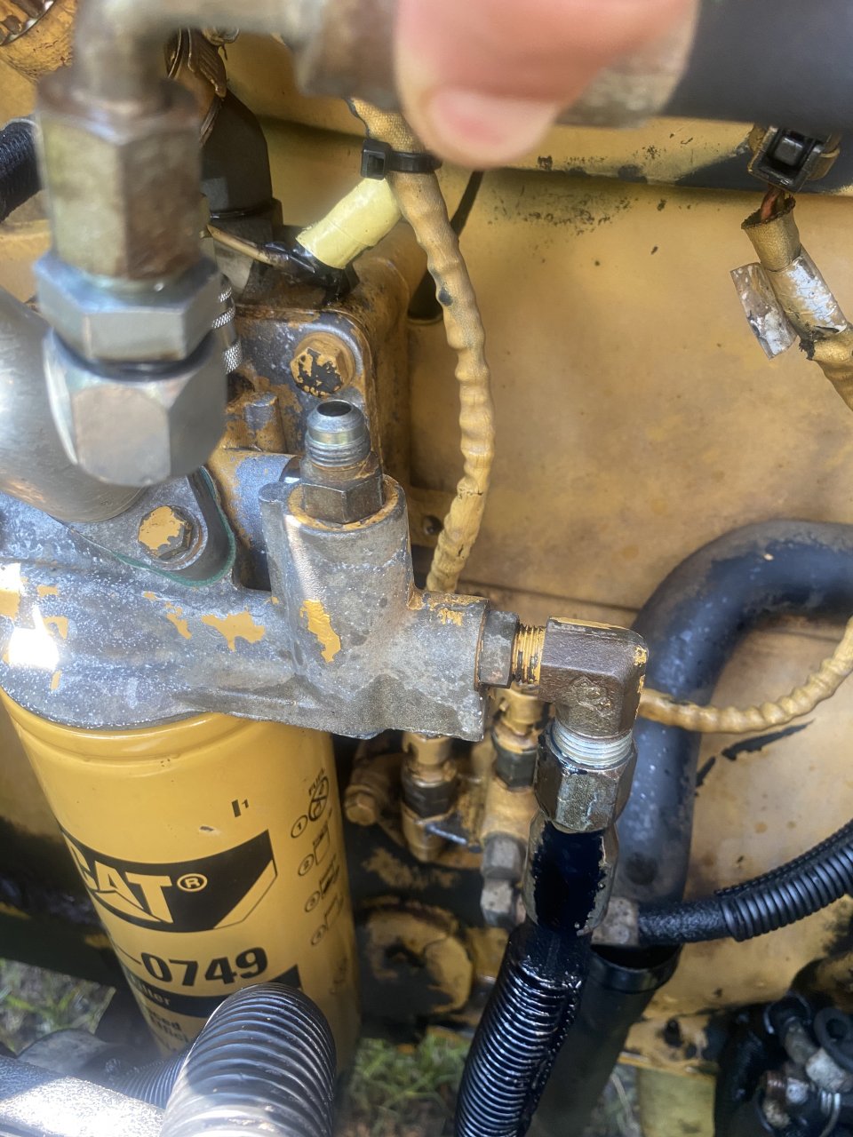

  5. 99sterlingdump
    99sterlingdump Bobtail Member
    33
    4
    Jan 24, 2019
    I capped off the line coming from the back of the head that goes back to filter housing, cranked it over and I’m still getting fuel returning to the tank? Would this indicate a internal crack on the filter housing? Could it be leaking by on the hand primer?

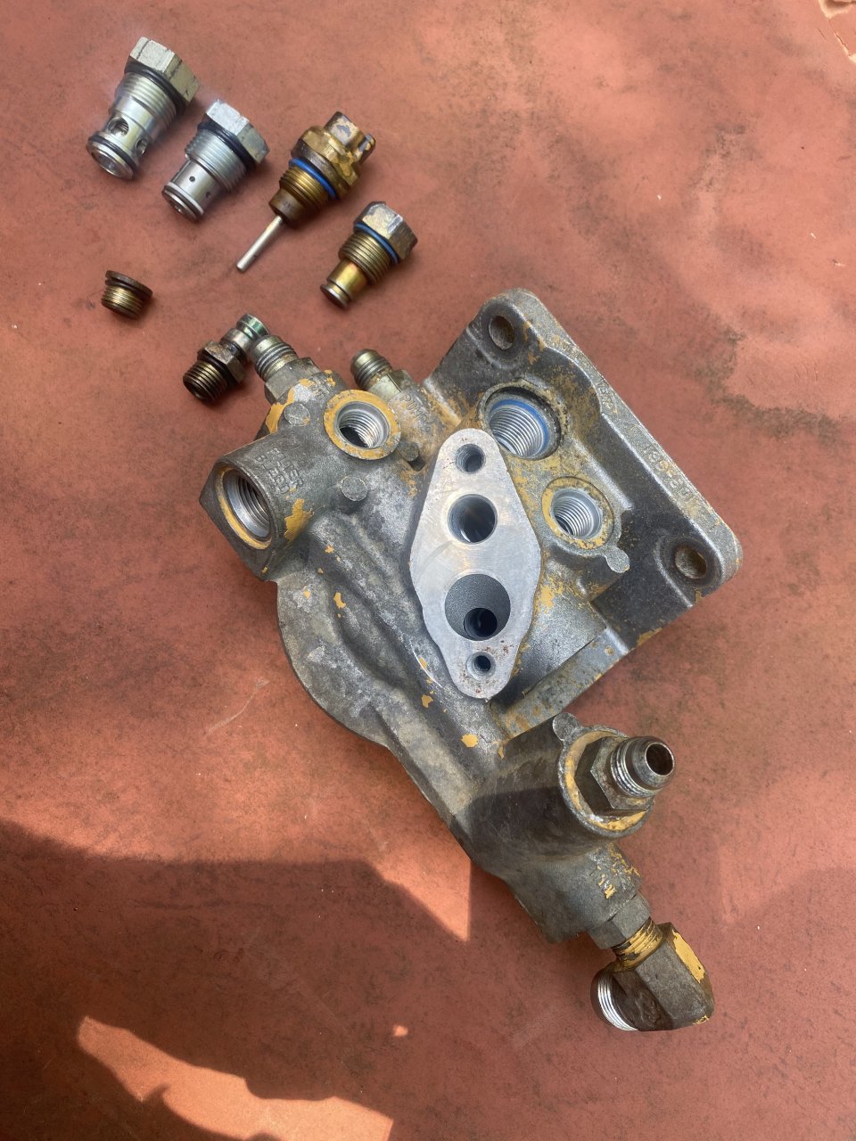

  8. 99sterlingdump
    33
    4
    Jan 24, 2019
    This is what came out of the filter housing! Do y’all notice anything missing, or maybe o rings missing from anything?

  10. lester
    lester Midwest's #1 Feed Hauler
    2,956
    8,085
    Jan 2, 2012
    NW, Iowa
    Think the bleed screw should have an o-ring in that groove. But I could be wrong.
  11. 99sterlingdump
    33
    4
    Jan 24, 2019
    I put a oring on it and now I’m building pressure. 35-45 while cranking but still will not start without ether. I notice while spraying ether it takes the fuel pressure to get around 60 before it actually starts.
