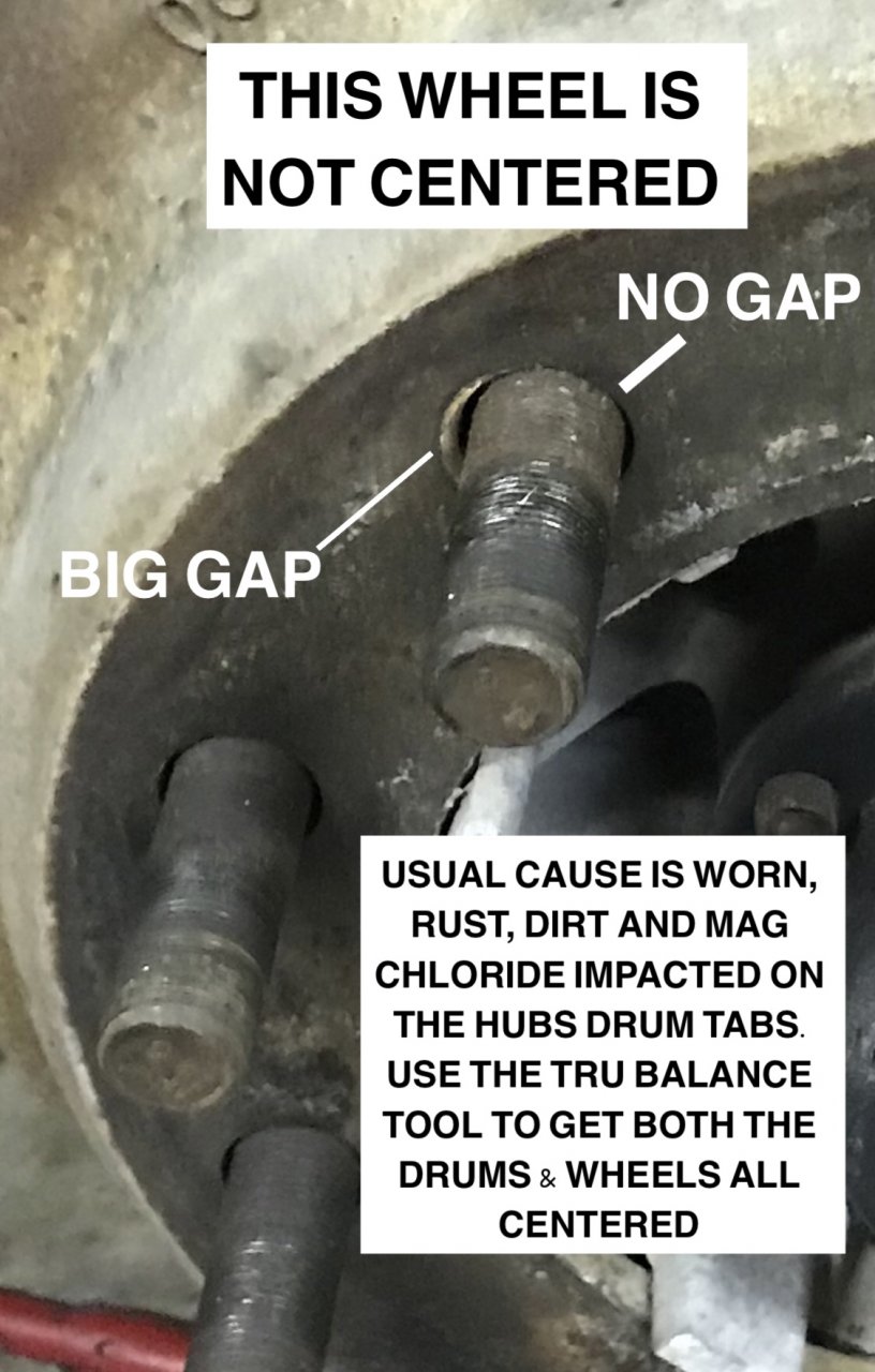

    My problem recently was the local tire shop did not ensure my brake drums were centered on the hubs as well as the wheels being centered on the drums. At 40-45 mph it felt like the whole truck was going to vibrate to pieces. I now carry the Tru Balance tool set to properly install all drums and wheels together anytime I have tire work done.

    Tru Balance makes the centering tool(s) for the various types of hubs you have. You can order for newer hub pilot or older stud pilot. I now use the tool and the results are amazing. The tool centers your brake drum and your wheels.

    It is very easy to check if your wheels and drums are “tru balanced”.
    Wheels: remove 3 lug nuts at 10, 2 and 6 oclock and the wheel lugnit “eyelets” should be dead center on each stud.
    Drums: remove the wheels and the drum eyelets should be dead center on the studs. Often you have to clean the tabs on your hub to get rust, dirt or mag chloride off the tabs.
    If drums and wheels are not centered on truck or trailer you will hop, shimy and shake thinking the tires are out of balance.

    YES. A buddy did his brakes and when spinning the drums there was a bad rubbing in one spot as he spun the drums around by hand. I told him to check and see if the drum was “dead center” on the studs…they were not. I told him to remove the drum, clean the hub tabs that the drum guides and rests on and problem solved.
