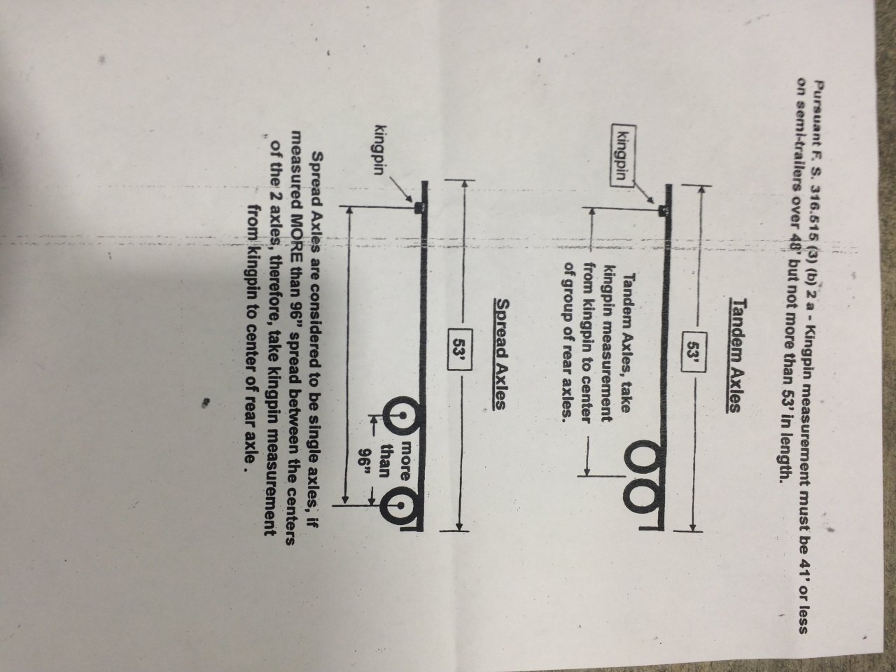

    Someone just posted the citation of regulation (check the posts above).
    You need to close (join) the rear axles because KP from the middle of rear axles cannot exceed 41'.
    Check the attachment. The weight station officer gave me this paper.

    Yeah. but that's for just Florida? I guess I'll just reference the rand mc nally for each state. Right?
