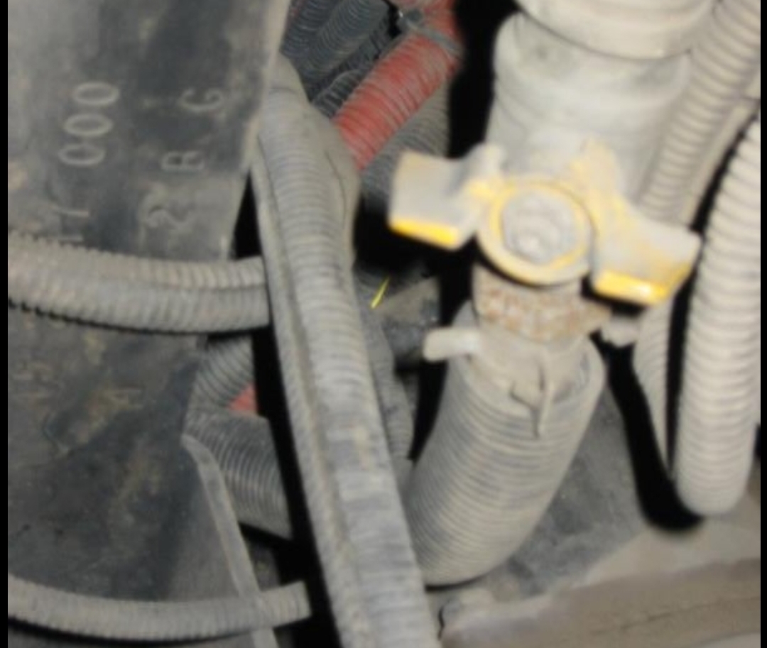

    Check under the hood. There's usually a valve in the lines from radiator to heater core. Might be on the supply side to the core, might be on the return, or both.

    Look for these under the hood on passenger side of engine. Screenshot_20231008_073849_Google.jpg

    The valves to the cab were probably shut off during the replacement of the cab heater core, and never turned back on.
