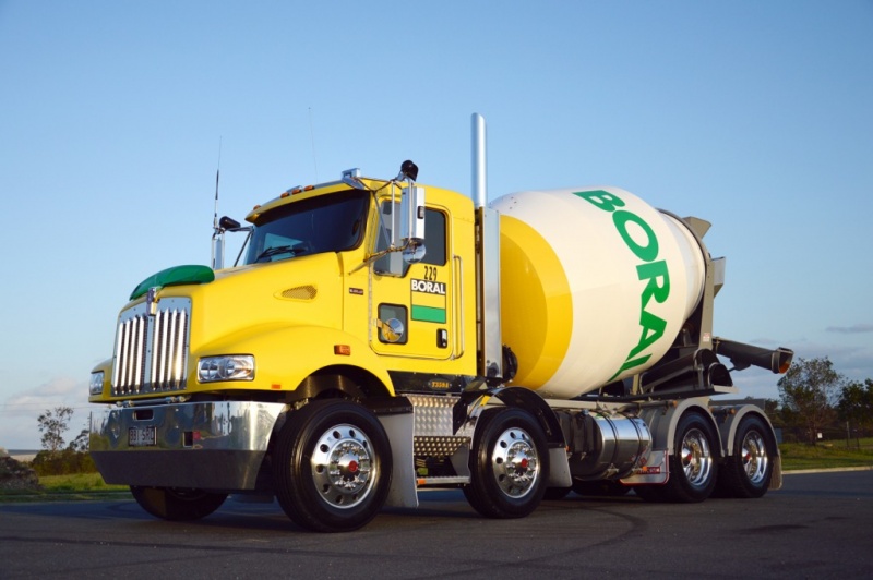

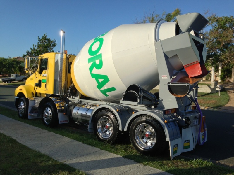

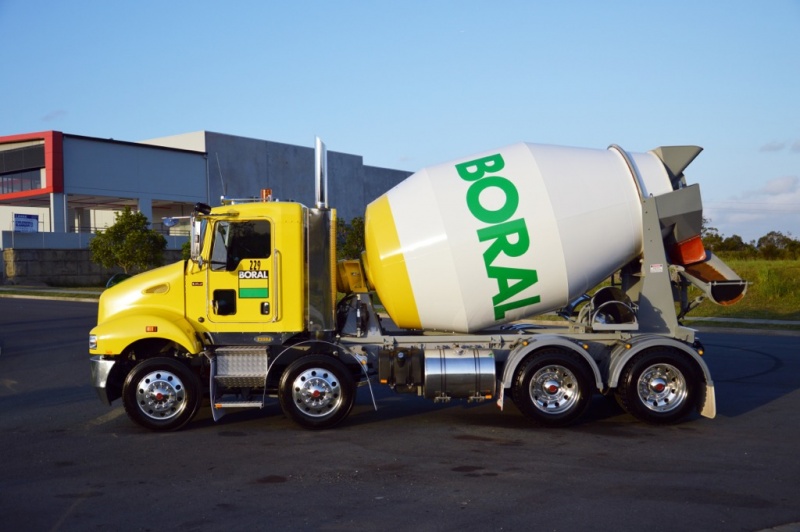

    This is my new truck that went on the road last month
    Kenworth t359, cummins isle5 400hp, roadranger 14909-ALL, Kenworth ag400 8 bag rear suspention, danna 46000lb axels with 4.88:1 diff ratio, load share parabolic front springs, low profile 275/70 r22.5 tyres
    The truck tares at 10,620kg full fuel and 200L water and me in it. The cab-chassis was 7580kg so the agitator is 3040kg and is a 7.6m3 bowl
    With an 4 axel truck we can go 12t on the steers and 17.5t on the drives but only up to 28.5t gross, a five axel truck can go to 32t, we can't go past these weights at all.
    This gives me a maximum payload of 7.6m3. No truck can carry more than this as the kw is the lightest. But most american trucks can still get 7.6m3. 5 axel trucks are getting 8.4m3.
    Kenworths run single chassis rails with alluminium cross members, we don't like to run double chassis rails in this application becuase the water and crap get between them and rust them out.
    Mack, Kenworth and freightliner run single rails and iveco accos run double on the front only. I have never had a problem with any of my kenworths chassis or cross member, have had other brands rust the chassis and had a couple of broken cross members.
    The Mack metroliners with the Volvo chassis are having problems. When the first came out becuase the Volvo chassis is 30mm taller and the Volvo front suspention is taller they had to redesign the bowls and so plants so they could fit under them. Also they are flexing too much and are cracking the chassis' on the bowls. I have seen 2 different brands crack and one completely snap and the bowl nearly fell off the trucks. I have never seen this with any other brand of truck.

    The water tank is mounted on the right hand side. Good for easy access for filling. Some trucks have them mounted like yours above the barrel gearbox, but not many.
