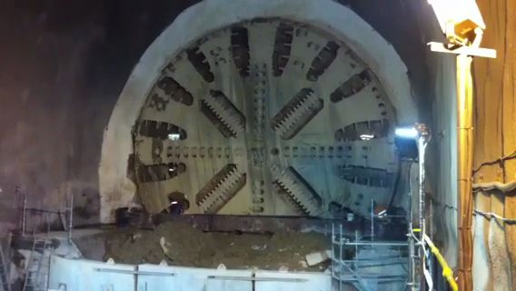

    Here are just some videos and pictures of a job which we just completed to show you some of the conditions we work in. It is he 6.7km long Airport Link Tunnel in Brisbane. Between Boral, Hanson/Heidelberg and Holcim which are the 3 main concrete companies in AUS, we delivered 1.8 million m3 of concrete in 4 years. I was only able to get a couple of videos and pictures because phones where banned on site so we had to do it very sneakily. The conditions where pretty bad down there, mud up to 1ft deep everywhere, and in the early days until we where about half way through you where walking and driving around in 2ft of water. Only about 2.5 km of the tunnels where done with tunnel boring machines the rest where done with mining machines and spray concrete so we where some of the first people in the tunnels after the had dug and blasted a new section.
    This is the access ramp to one section of the tunnel, doesn't look as steep on video but it was, look at the marking on the wall to how far it drops to see. plus it was usually covered in mud from the articulated dump trucks. we used to slide up and down this all day. 5 axel trucks were not allowed on this ramp because one snapped it's chassis trying to come back out, it was pretty hard to get out especially if you had left overs on and many trucks had to get big run ups to make it out. if you listen you can here my sliding a little bit, and this is after the fixed it up, the old goat track you can see beside it on the right was alot worse

    This is the face of the tunnel boring machine when it broke through. The hole in front of it is where the buried it.
