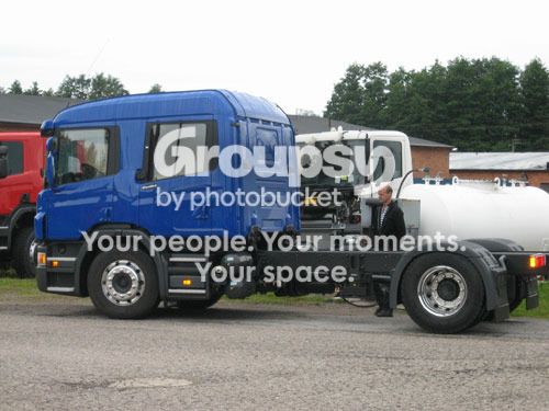

    in europe situation with fire trucks is :
    they are based on normal trucks, with several modifications, most of brands dont offer crewcabs but those are aftermarket conversions , either fiberglass or metal for heavy trucks,light trucks are available with crewcab almost at every brand
    scania make crewcabs for a long time, some even back in 60s, volvo started to offer them last year.
    scania have lot of fire truck market mostly because of cab, and i would say together with mercedes dominate market around world
    cab is being built by Laxa special vehicles which used to be scania plant, private since 1999 , scania have some 30%, shares
    cab are built from unused parts, it is not conversion like other do(cut and extend), but they make cab from sheets , of course they use as many as possible of standard parts which are shared with normal cab range , for example rear wall of cab is from conventional T series which are discontinued , rear doors too,
    those cabs are well protected against rust (unlike scania chassis) so this ensure long lifetime which is usually expected from fire truck.
    they were in 8different hot zinc baths , ( normal cabs just cold zinc spray at line)
    conversion cabs tend to rust after some time
    so this is very interesting to me about US fire trucks, if independent manufacturers find a way to build them.
    but big brands dont find a reason to build one, market for this is very small for sure, but could find a way to sell them for some applications
    especially since most of US manufacturers have something in common with EU brands, they could borrow cab

    here is what scania offer,
    CP28 , low placed cab, entry at 1160mm(3ft 9.5in) front and 1220mm(4ft) rear (depending on chassis height)
    it come with 2seats in front, and 4 seats on bench at rear , available up to 450hp in europe and 460hp at export markets,
    engine tunnel is only on front section of cab, 460mm high 18inch high( very high for our standards)
    at rear floor is flat
    and there is water drain on floor, so this keep things simple
    Scania offer several types of bench ,basic come only with seat bench
    medium is same only with backrest,
    lexury have seatbelts
    Rear bench storage
    Fixed
    Storage compartment under the bench accessible by raising the Seat squab.
    Storage with lid
    The storage compartment under the bench has roll fronts on the left and right-hand side.
    Rear roof shelf
    An extra roof shelf at the front of the crew area. The roof shelf has a two-door compartment.
    Pump area ,
    Adaptation in the rear of the cab to enable the fitting of pumps.
    you can get also driveshaft tunnel if needed
    Additional Air Conditioning
    An extra evaporator for the rear roof is connected to the front system. The air is distributed through four louvers in the roof cover.
    more interior photos
    it is available with high roof, called CP28H gives 1720mm of standing height -Laxa SV use this truck to transport cabs to Scania plant
    crewcab is available with foldable steeps, or extra step if truck is AWD
