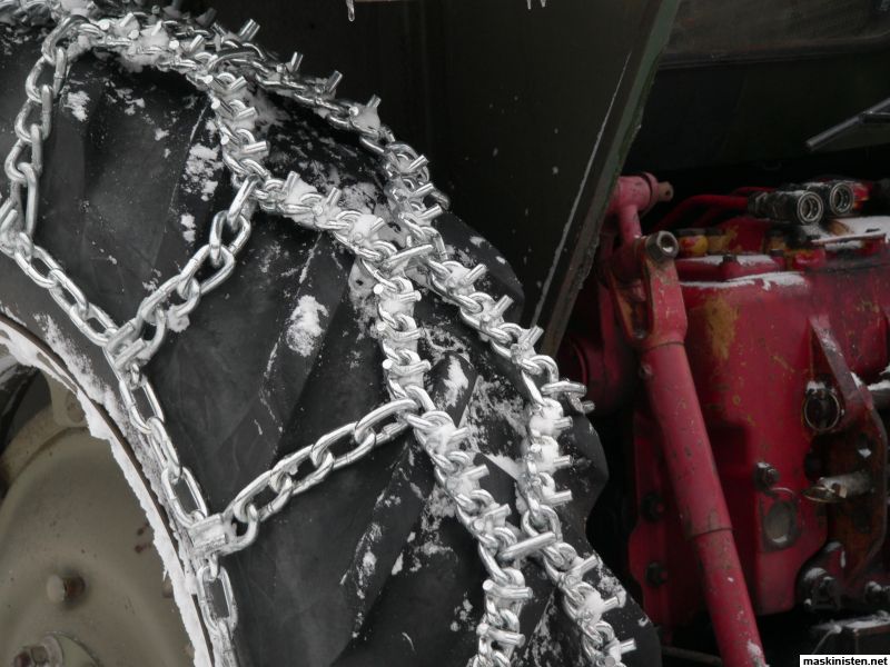

    Thats the thing, the 6x2 are not to expensive, just rise the bill to the same as every Nordic driver and it won't be a problem any more and who care if it's to heavy, it's peoples life's we are talking about, just take a smaller load. You buy the truck for where you are going for example the company I work for drives to Norway meaning tag and big engines. If we would drive sweden and finland it's a 24m or 25.25m combination and to southern Europe it would probably be a 4x2
    First of all, real tires (observe, not just Norway but Sweden and Finland to (when the first real ice hit north Sweden there where seven!! east European trucks that had an accident just on the same highway, I was on the same road and couldn't see any problem)). Meaning drive + steer and the middle trailer axle to + last for even better grip
    ex.
    http://www.nokiantyres.com/tyre?id=10932358&group=4.02&name=Nokian+Hakkapeliitta+Truck+E
    Bridgestone has a very god tire to.
    Ice chains! (Norway requires 7!) not the stuff from us. This a tractor but only picture i could find whit the right stuff.
    Lift able first trailer axle, not just remove pressure. A movable fifth wheel (right name?) so you can get better pressure, none cares if you are to long on the highway if you are able to keep the truck moving.
