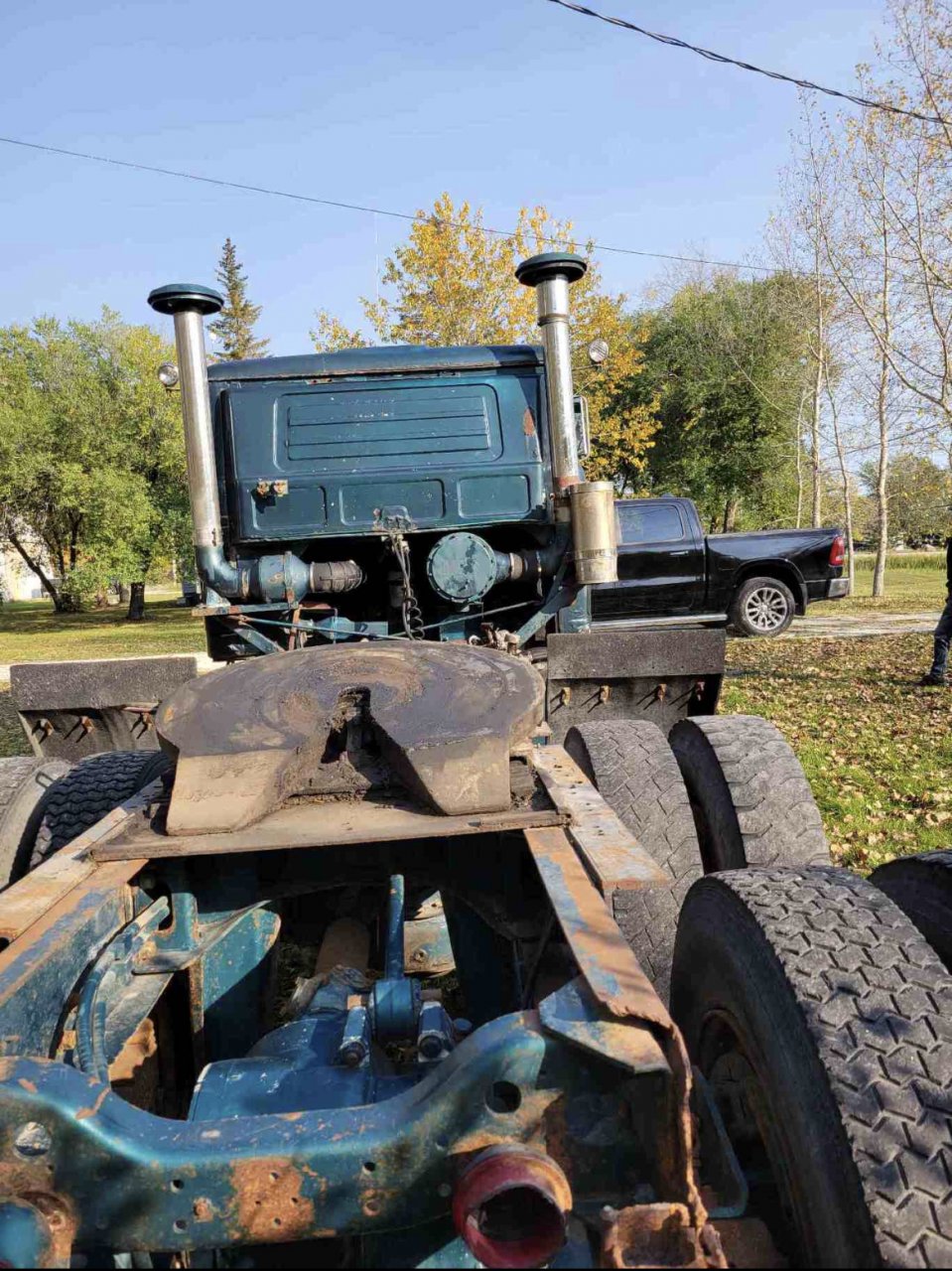

    C099CF33-5C4A-447D-94BF-9DA5AF938A12.jpeg 2679049E-0718-4D9B-BC66-5E3313123644.jpeg E5B25CD5-BC2C-4062-980A-028C8000FADC.jpeg A former coworker and his brother bought this one to rebuild as a tribute truck to their late father. They are both very accomplished builders with numerous show trucks between them though. Engine and transmission are great for a 4500 dollar truck apparently.
