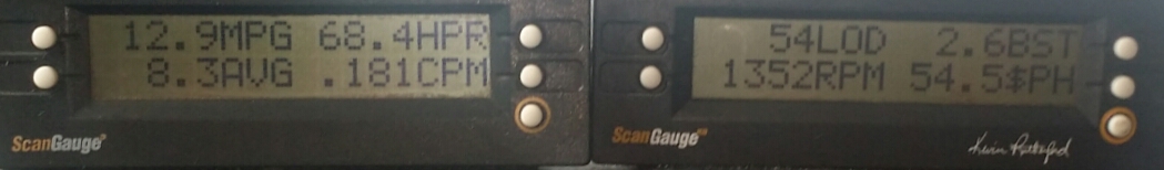

    They are 95+% the same, but here are the differences off the top of my head:
    The KR:
    will display ecm odometer mileage
    will keep track of 2 trips
    keeps track of profit per mile
    has profit per hour
    by default it has a smoother (slower) mpg display, but this can be adjusted to match on the D.
    The D:
    Keeps track of 1 trip
    keeps track of fuel cost per trip
    keeps track of fuel cost per mile
    Aside from that they are the same (aside from the price & Kevin Rutherford's signature). The D can be reprogrammed to KR specs for a small fee.
    These codes match my 12.7 detroit: https://ddcsn-ddc.freightliner.com/cps/rde/xbcr/ddcsn/1-SECM-03-05.pdf
    For most folks, I'd agree. But the profit per hour display could easily pay for itself if you are on a mileage pay-based lease & on e-logs. Using it you can quickly determine the optimum cruising speed or gear for a variety of conditions.

    The D keeps track of 2 trips. A & B. The factory default is 2day and previous day, easily changeable in settings
