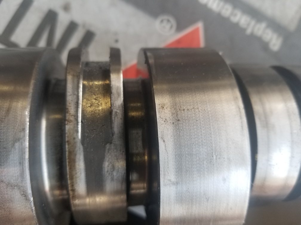

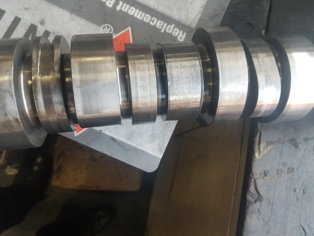

    So about a month and half ago I had a 6pack done. Now it just didnt seem to have much power and mpg was slightly off. Today the shop calls me and let's me know exhaust rocker 5 and 6 are bad as well as the cam.
    That means this cam only survived about 120k. I been doing 12k-15k oil changes with Rotella T6. I have idled alot this year.

    Something has to be wrong with install or adjustment oil psi to head there is no way that can should last only 120 k unless the rockers were bad or almost bad from last time and were never replaced but make sure you check rocker oil psi something is going on.

    What year is your truck??? Does it have shims for exhaust valves bridges to adjust exhaust valve clearance?? Are both 5 and 6 lobes look the same?? How’s the rollers feel and look that were touching those lobes??

    5 and 6 are being replaced. Will ask for more information.

    2010 used the shims, sometime in 2014 Volvo got rid of them. After installing new camshaft they will do overhead again, it would be nice to know what shim numbers are in your cylinder head for cylinder 1-6 as it will tell a little story of what condition your exhaust valves are in. IMHO this damage might as well spread to your exhaust valves as it probably wasn’t closing them completely and leads to valves not cooling down properly. Once they will be done warm up your engine and do compression test on a Volvo ptt couple times.

    that has been bad for a while making that kind of mark on the trans.
