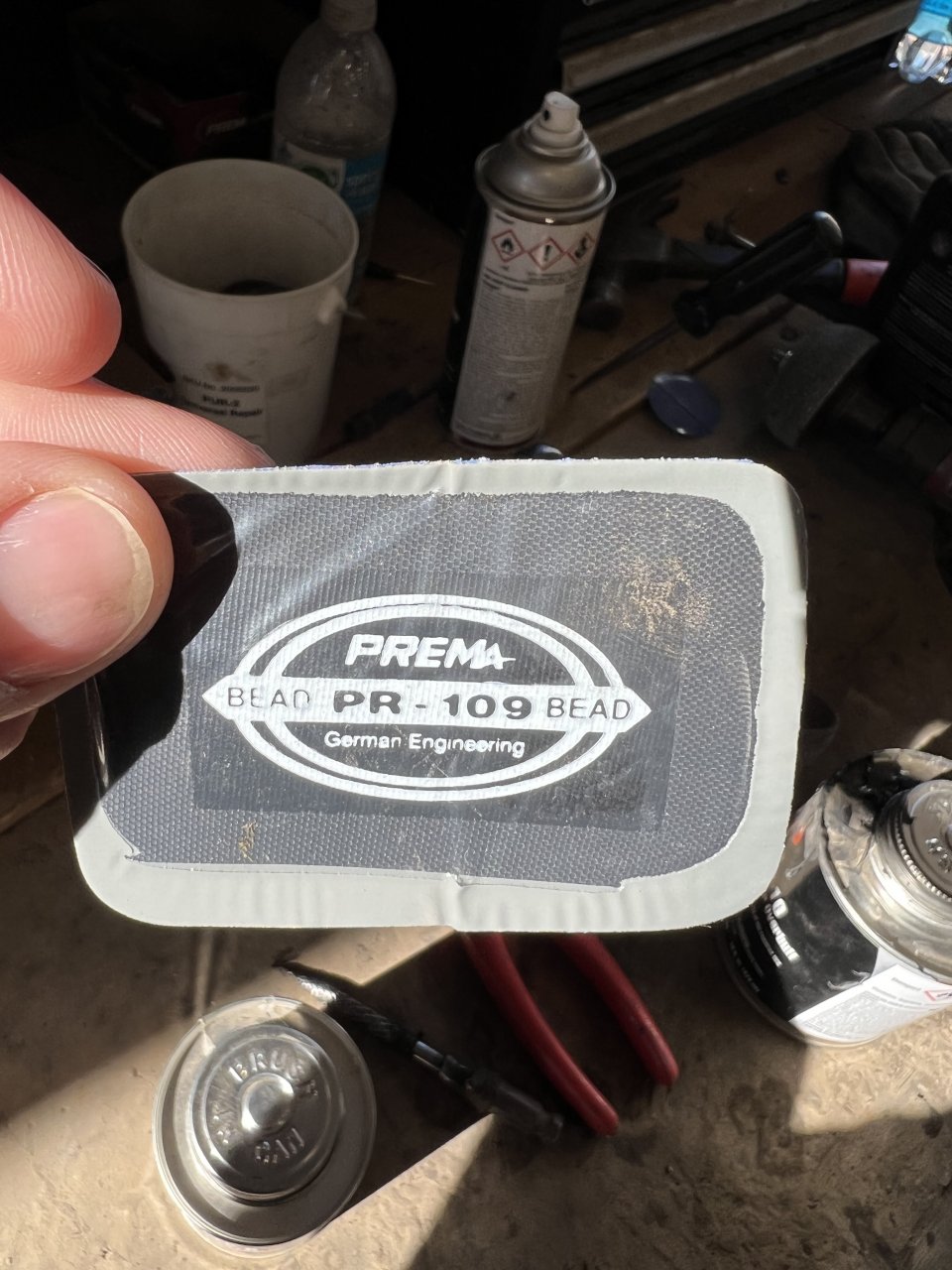

    I ended up getting a shop to do it the right way with a plug and patch.They say they do it all the time and they’re a pretty decent size company in ND.
    Hammer166 and Siinman Thank this.
