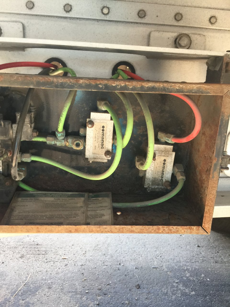

    Just don't know what it is for. It has air lines. The trailer is a 2007 Manac. New to me.

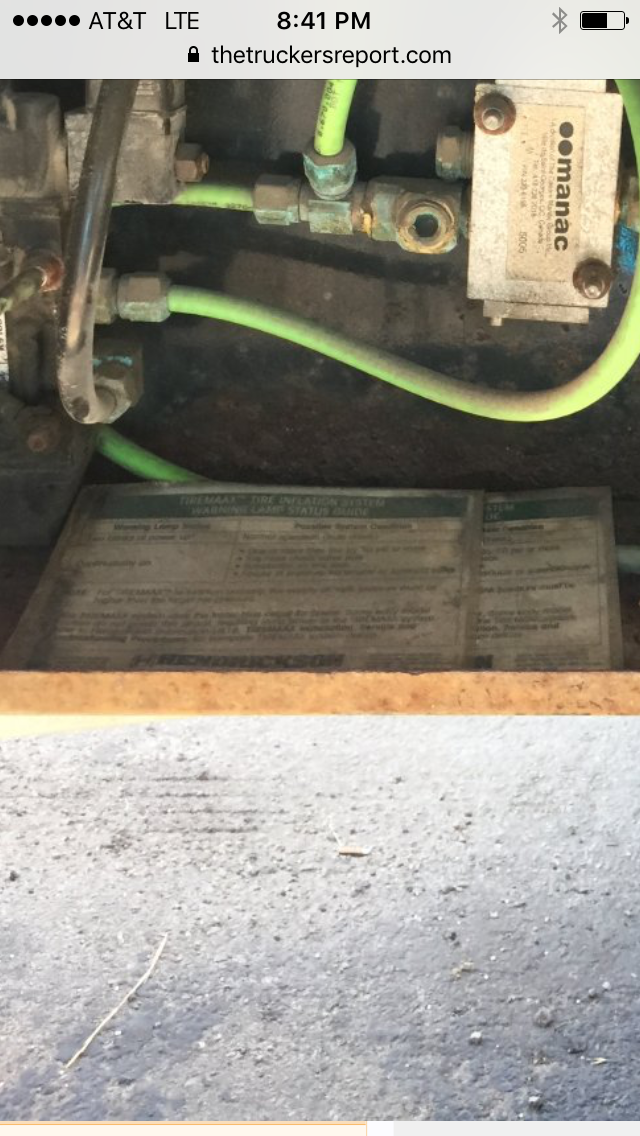

    Says it right in the bottom left corner, it's a automatic air inflation kit for all the tires...

    I agree. Looks like somebody removed the lines and put on normal hub covers too so it's not connected.

    Tire inflation system.

    Should be a rod connected to a valve up underneath. What do your rear airbags look like when you're loaded and the suspension is charged?

    Not unless you're driving around with the dump valve on.

    Our Manacs have the same box, only ours is for the manual dump valve.
