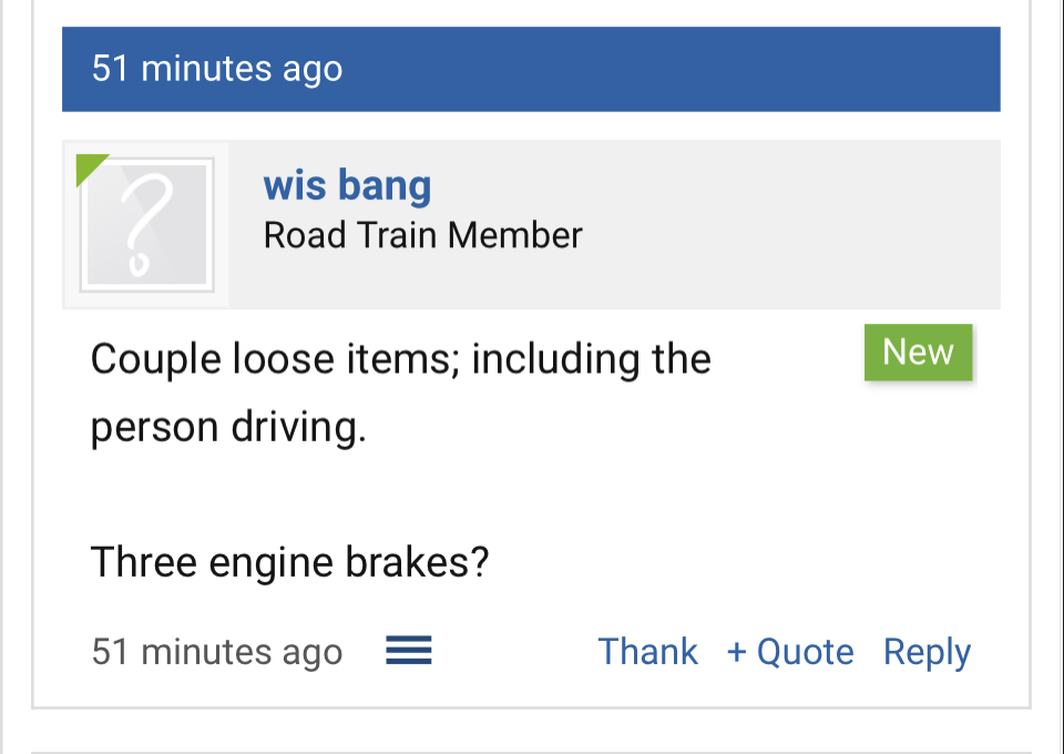

    Just curious where you got 3 clutch brakes from….??

    No clue how I missed that part, I’m going back to sleep….
