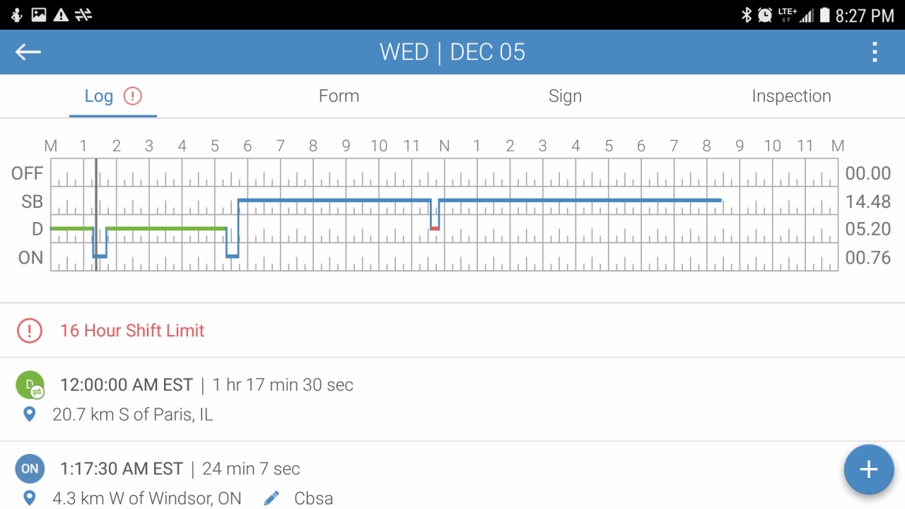

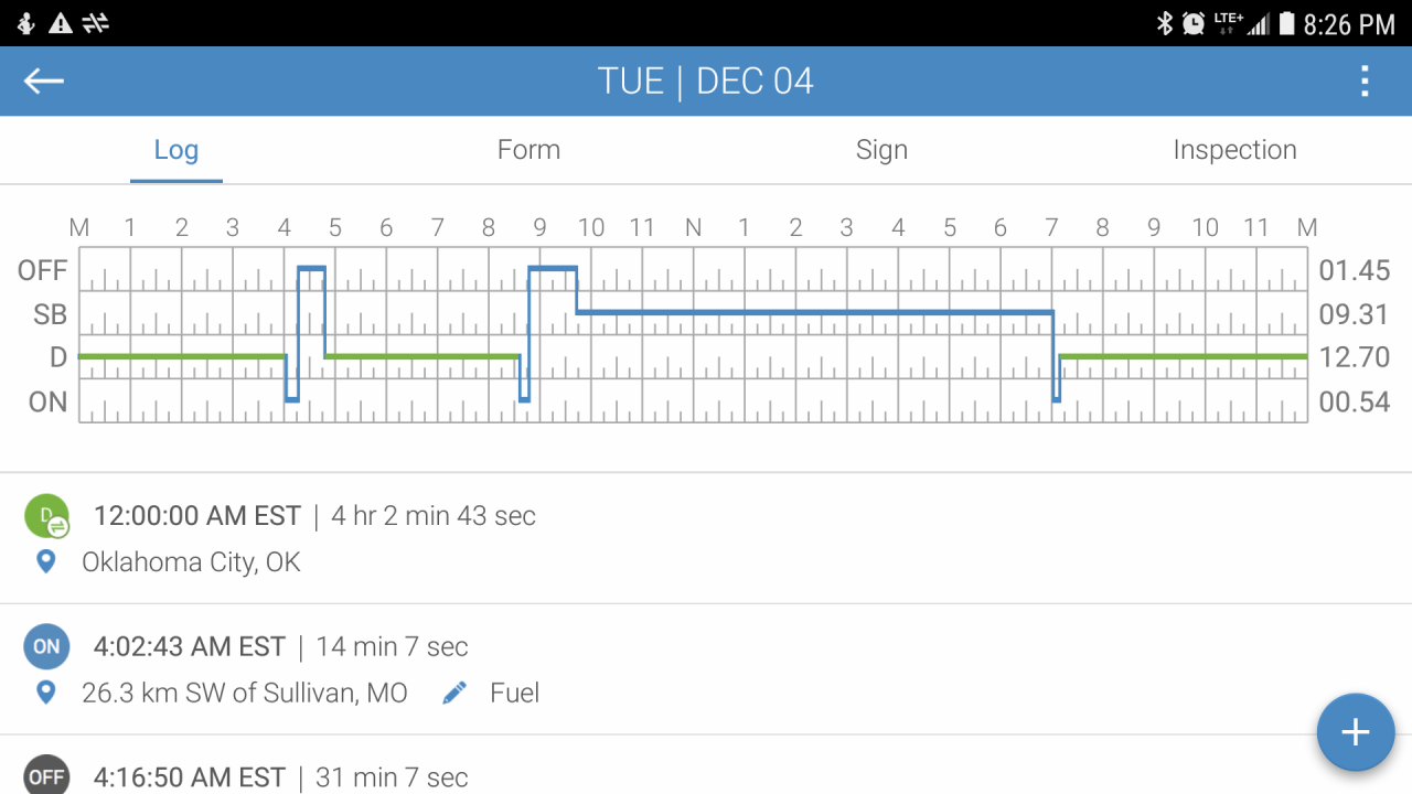

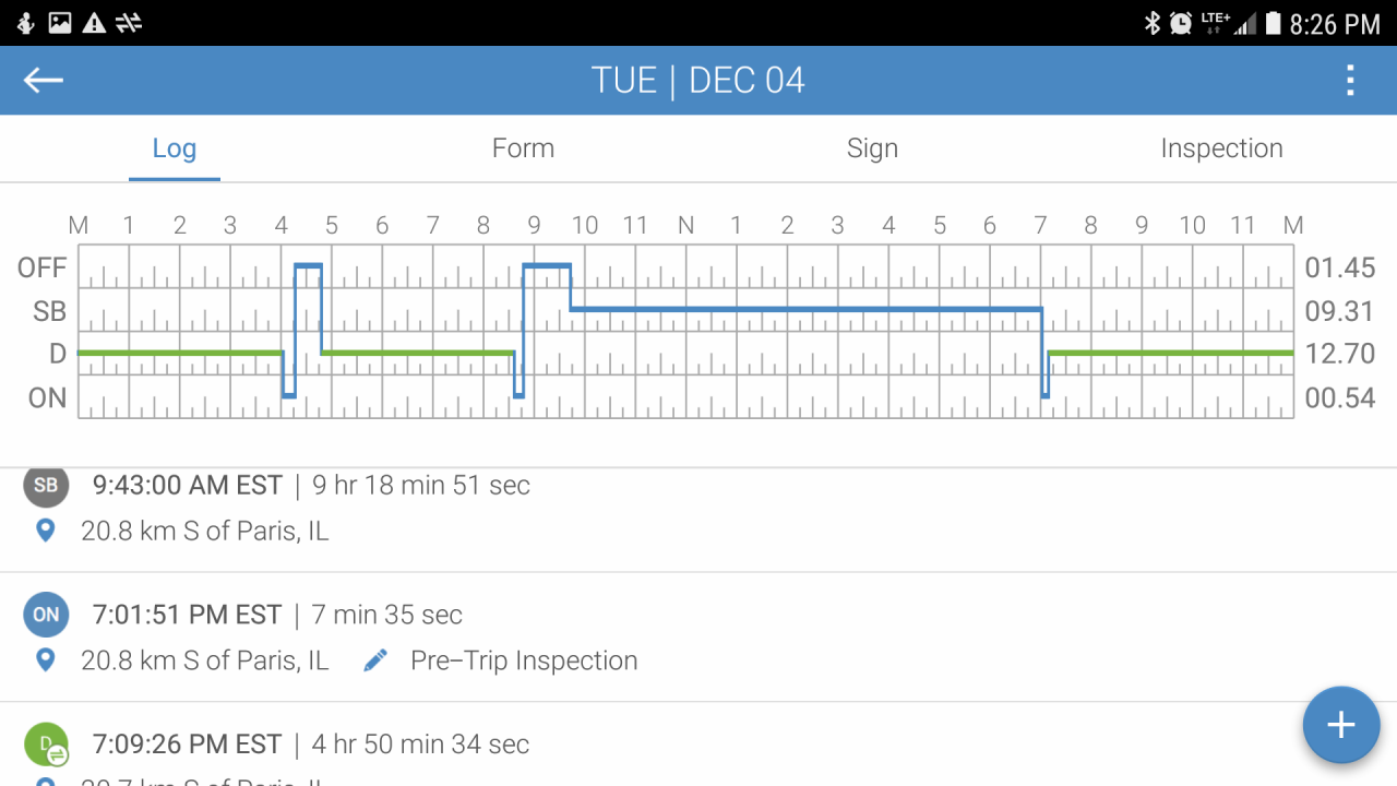

Tuesday evening: start shift at 7:01pm
[8 closes at 3am, Canada at ~130am-no need for 8]

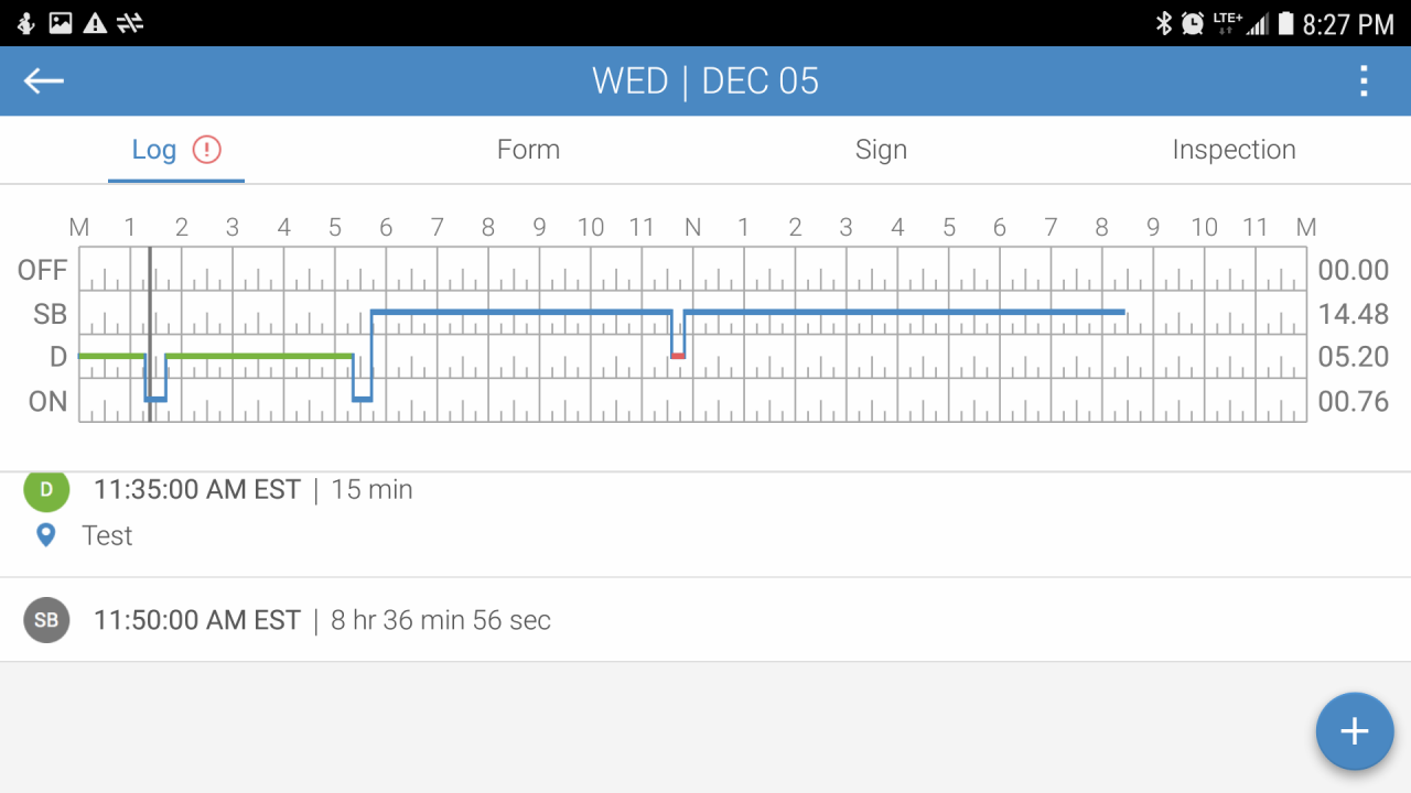

[16 closes at 11am] paperwork ready at 1135am. Kt elog says 0 time available. Edit in 15 min drive 1135-1150-it claims violation.
From your link 18 (1) (e) I break the 16 hour. But 18 (2) says to exclude any period of 2+ hours. So, at 11:35, is my actual time available still the remaining of my 13/14 ? It looks as I had used about 10 hours driving + 1 on duty at the point I backed into the dock. Leaving about 3 hours driving or the same 3 for on duty?
Do I have this correct and my elog doesn't have it programmed right or vice versa?
Weds at 5am I should have put receiver check in. :/

At the time I actually drove it, about 1135 am to say 1155 am - it says 0 time available- you are in violation!
Then if I stay in sleeper for enough time after; parked legally now, it changes to, "oh, that was legal."
I don't get the 16 hour calculation. To me, it closed at 11:01 am Wednesday. It seems to agree with me. Until after the fact. -

The part that doesn't make sense. It is if I drive a short 20 min it's violation. If I do 2 hours it says it's fine. At the time of doing the driving it is saying I have 0 time available. After I've completed a bunch more sleeper after the fact, the 2 hour would of been fine but not the 20 min.
Clear as mud, lol.
I am going to leave it as 20 min when I actually did it. And if I have an inspection I will hopefully get their opinion. I have screen shots. All I want them to do is tell me how to be legal :/
