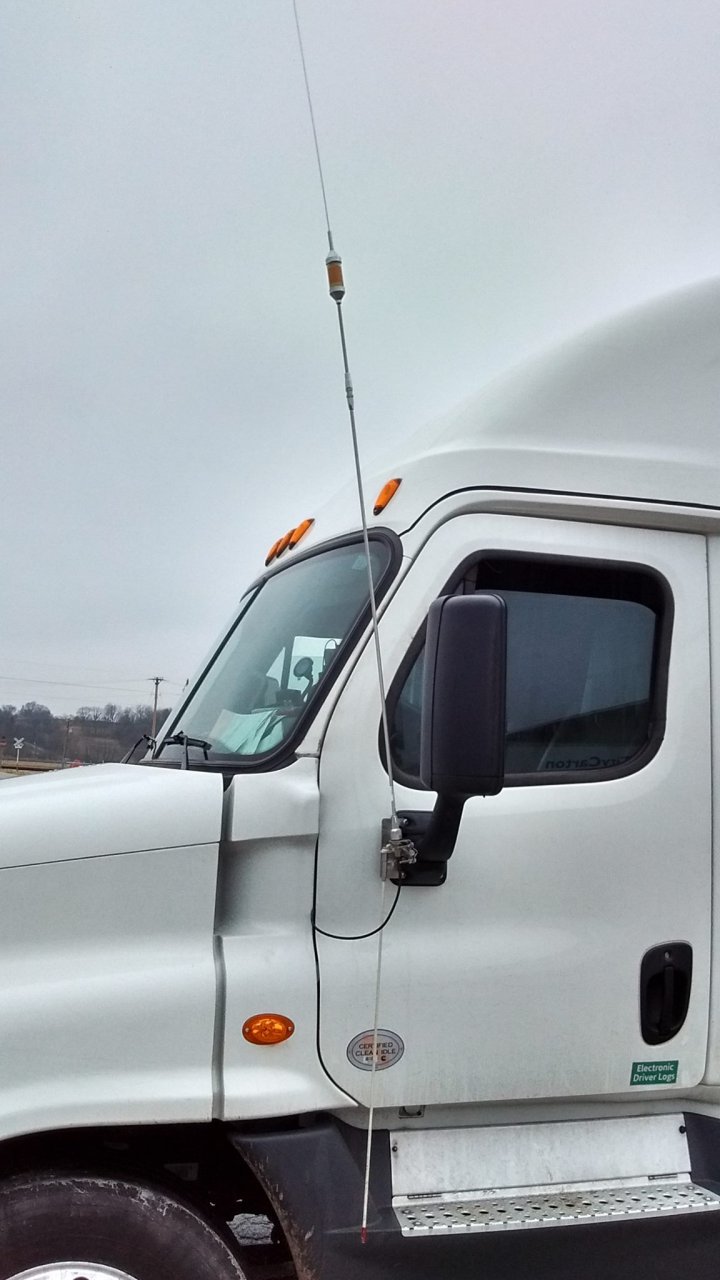

    Otherwise, sell it and get a 7' Firestik, a 102 whip, or this:
    That's an Oil Coil with a 44" SS shaft from WalcottCB ($32.95) and a 10" Wilson shaft joined above it for a total of 54" of shaft.
    You will get down the road 15 miles easy with a barefoot legal CB with the pictured antenna, so long as it is tuned to actually be resonant on the CB frequencies. Note that you (or the shop you use) MUST use an antenna analyzer, not just an SWR meter, to verify resonance. Another note, if you go with this antenna specifically, you will have to use a stainless steel perch mount. The aluminum Wilson one is too weak to support it and will not cut it. I ran it for about 3 years with the stainless mount without issue.
