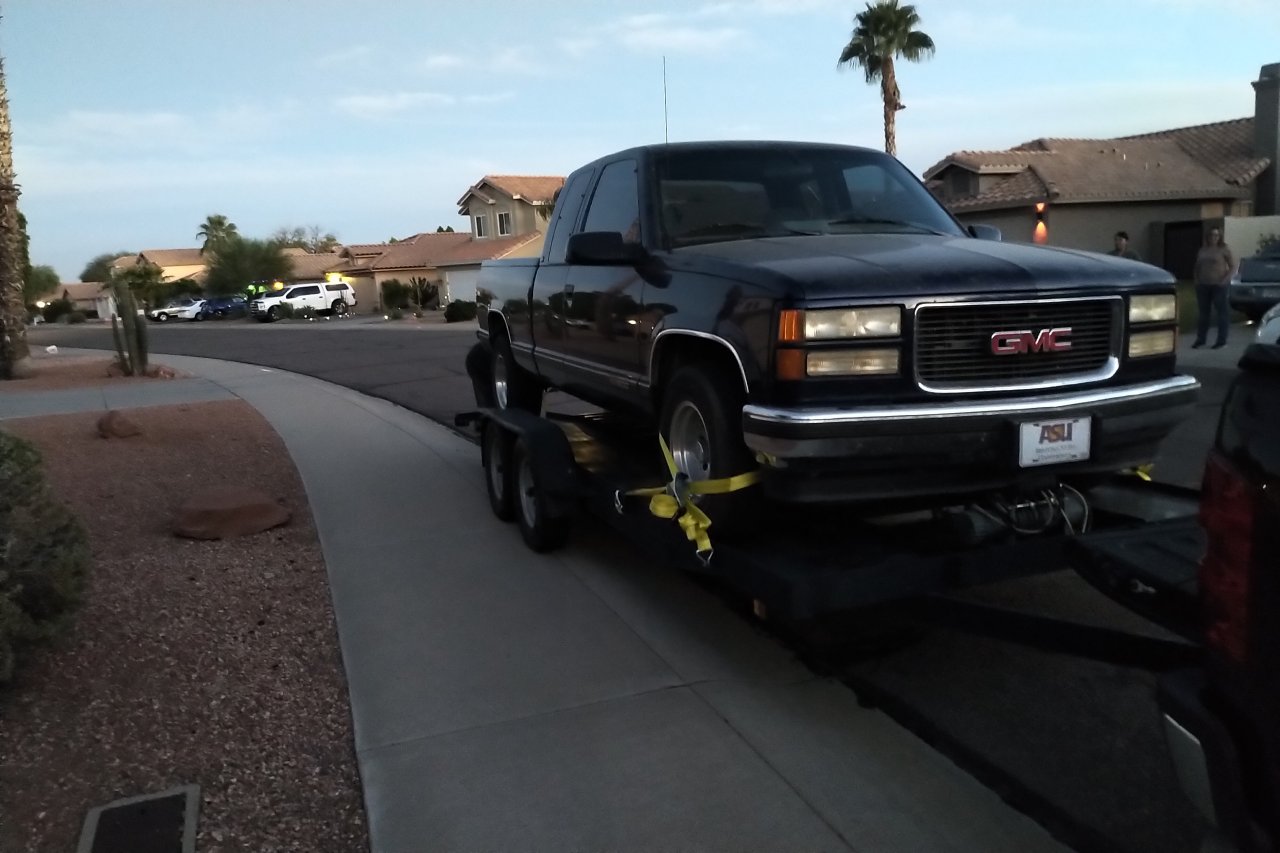

    What trailer do you have? Are u hauling just 1 vehicle like this ? Can make a "tire lasso" out of a ratchet strap... it secures so it is pulling both front and back

    i can do that on the front but not the rear,, and will probably be my plan b if i can't find anything really fancy locally. i assume it is not really a "lasso" but more of an x? i mean, it doesn't tighten on itself like a girth type hitch or lasso, right? but i can make axle straps work on the rear so no problem.

    Yes it's just an x... it tightens on the tire directly and you get pulling force in both directions so u don't have to tighten the snot out of it... on the rear you can take a strap and feed it thru your strap hook to make a sling to wrap around axle and hook ratchet to back end of trailer if possible...
    If u can take some pics of ur trailer and securement points and we can give u some better ideas for securement
