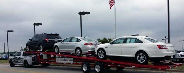

    I wouldn't trust a lightweight built wedge trailer with a car up high like that. Just asking for it to flop over on you. Get the other type if you go that route the low boy lightweight one that I posted. Personally I don't even like the heavily built wedges and putting a car or truck up top like that with all that weight on that skinny gooseneck.. too many pictures out there of wedges on their sides...

    My wedge weighs 6500 lbs(scaled it at CAT scales)
    Inserted a pic,been 10 months and it hasn't flipped yet,I've had 5k on the top ramps.
