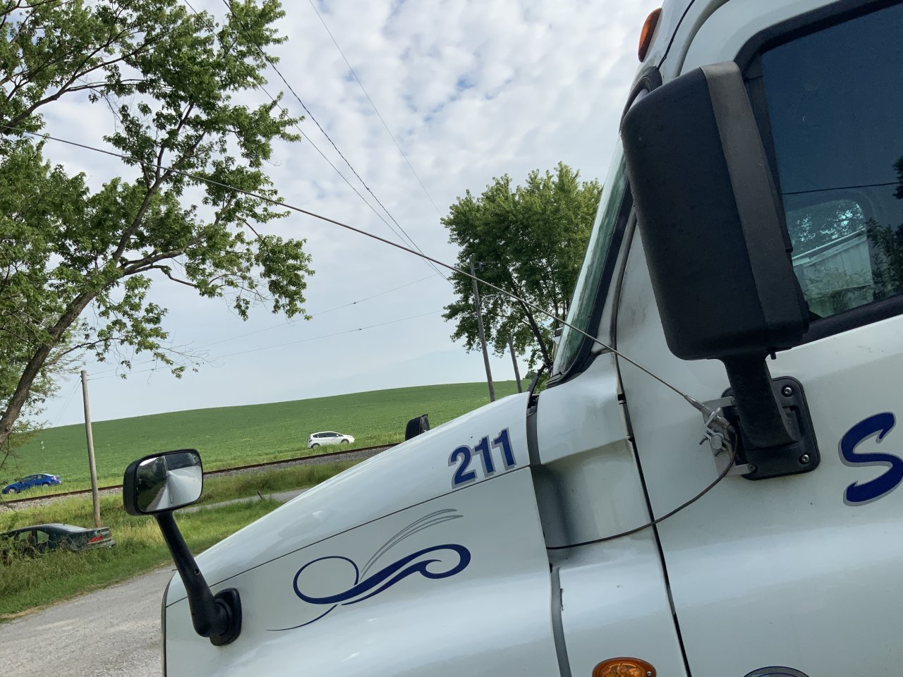

  6. Kevin83165
    Kevin83165 Light Load Member
    144
    106
    Nov 24, 2011
    Herrin Illinois
    0A3CF1D0-DD4D-44A3-98B1-7856DE20B218.jpeg Sometimes people make fun of me for having this big old whip on my truck but it works and it works well. Here’s a picture of it just for conversation purposes. It’s leaning way forward in the picture but I have it adjusted just right so that it stands straight up and down when I’m rolling down the interstate
  7. craig_sez
    craig_sez Road Train Member
    5,570
    2,714
    Sep 5, 2013
    novascotia,Canada
    Yeap..Get rid of that ant stud..total junk..Im surprized that the 102 even tuned well enough..Its electrically short..A 108" by itself would tune by itself..Find someone who has an analyzer to see where your tune actually is..

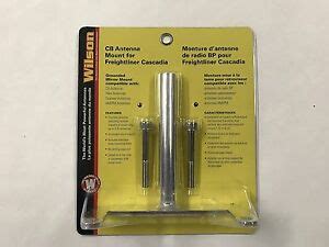

  8. Intothesunset
    Intothesunset Road Train Member
    2,289
    4,880
    Apr 15, 2019
    truck
    downloadfile.jpg If you have a Cascadia 2017 and older I saw these Wilson brackets at TA in Limon CO for $39 each. They had 5 of them on hand.
  9. craig_sez
    5,570
    2,714
    Sep 5, 2013
    novascotia,Canada
    Those are not bad but there are places that sell a stainless version...I think i got mine from bob's cb in pa...

  10. stacks
    stacks Road Train Member
    1,547
    850
    Oct 27, 2011
    Emerald Isle
    there for the older cascadia
  11. craig_sez
    5,570
    2,714
    Sep 5, 2013
    novascotia,Canada
    You mean they are.....Yes into the sunset mentioned the yrs they work with..
