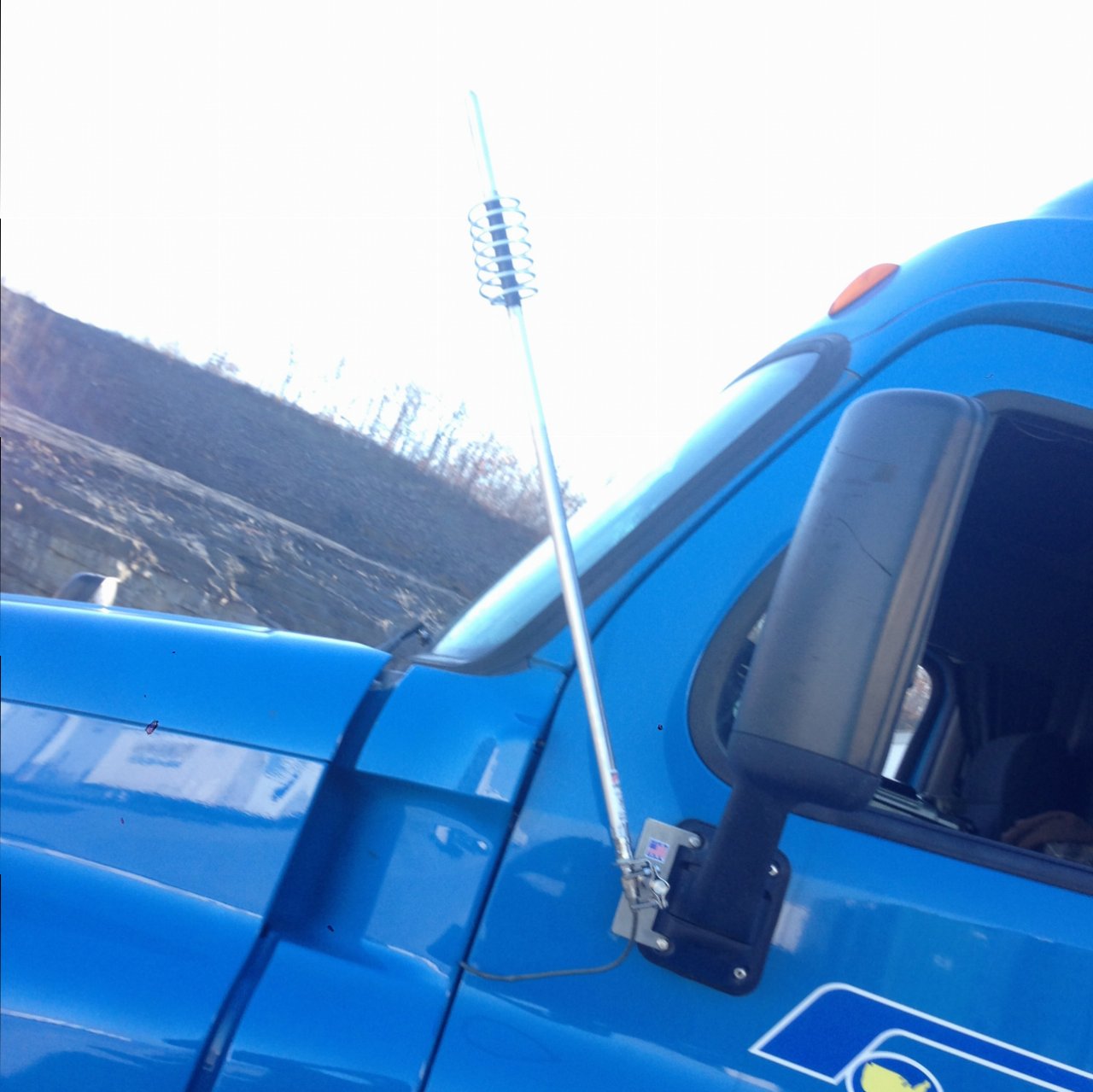

    image.jpeg My first Cascadia, I stopped at Bob's CB shop on I 80 exit 70 in PA.
    I got the stainless steel bird perch and hardware and a Predator antanaee,
    He thought I had bad coax, he tested it, and to my surprise, it was still good.
    He said I had 1.3 swrs,
    I'm getting feedback over the stereo speakers, but it's getting out and receiving good.

    Thats alot of angle tucker,it might be fooling the swr reading into being lower than it really is..Get someone with a analizer to test it and see what its really doin..Then a field strength meter to plot its trans mit direction..
