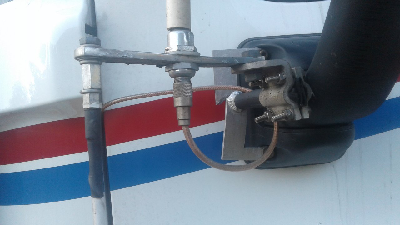

    20170517_064158.jpg Well it took 2years but the mount failed. Tried simplifying the design to help new bracket last longer but antenna wouldn't tune. Cleaned up corrosion and reinstalled tuned right in with new mount.
    rabbiporkchop Thanks this.

    I've got a Stainless Steel one I probably won't need any more after this year if you or anybody else is looking at long term occupation in a Cascadia. It won't ever break.
    Neverready Thanks this.

    Where did you purchase your bracket?

    Didn't he have it made up by a friend of his?
