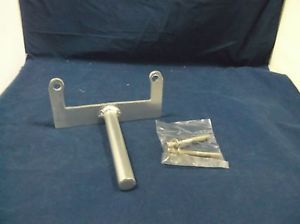

    If you don't rough up or knurl that stainless steel post, and you use a stainless steel bracket, the bracket will spin on the post. At least mine did until I roughed up the post. You can see where my bracket is bent a little because I kept tightening it down trying to get it to quit slipping FullSizeRender.jpg
