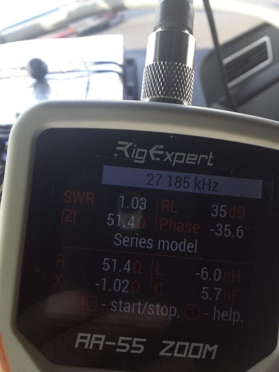

    I got it from a ebay seller named rfservices1 i think...Just did a quick search for it but no luck....I did see a 6" riser that you just screw in your 102 to but thats not what i got...
    Maybe cont him through fb and see...If i remember right they were about $50....It was nothing more than a 10" riser that your 102 would slide down into after you cut the threaded end off..Once tuned you just tighten the locking stud....If you find one please dont forget a lil touch of anti sieze on the lock stud then cover the top part where ant slides in(after a tune)with coax tape or something....I got to excited with the performance and forgot,now its siezed....
