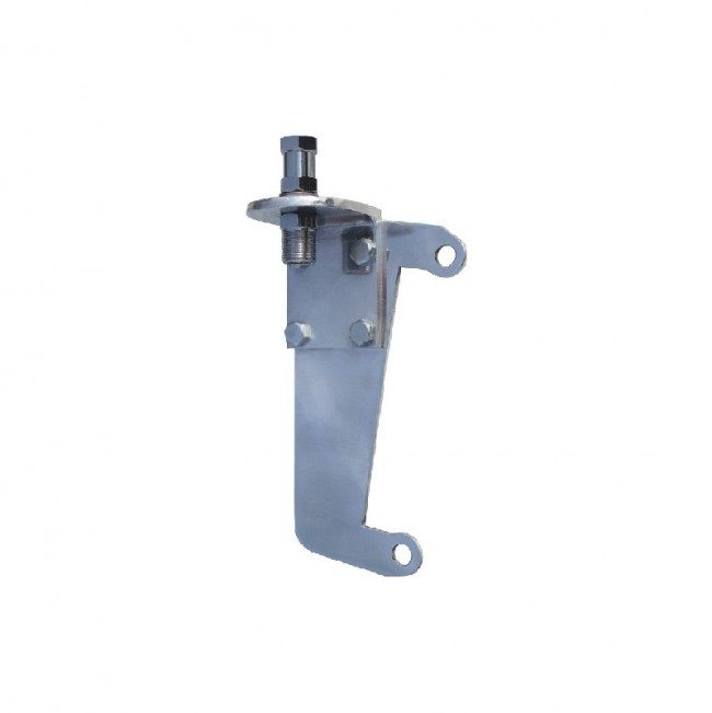

    Oh yeah..The entire bracket will have to be changed in order to use the 7 footer..

    All i have is my predators(single/duel coil...6"/18"/22" shaft...
    A 4.5 ft fs with the wire up top for tuning
    A 5 ft fs with tune able tip
    40" tall mount you seen already and pics of the two here mirror mount.jpg mount.jpg

    Now you just need a rectangular plate with a couple holes and a couple plastic insulators

    Just gonna try volvo244's method..

    My bracket was slick SS. I took a dremel tool with one of those cutting wheels and just etched me some lines in the bracket. It was slipping before, hasn't slipped since. It doesn't take much.
