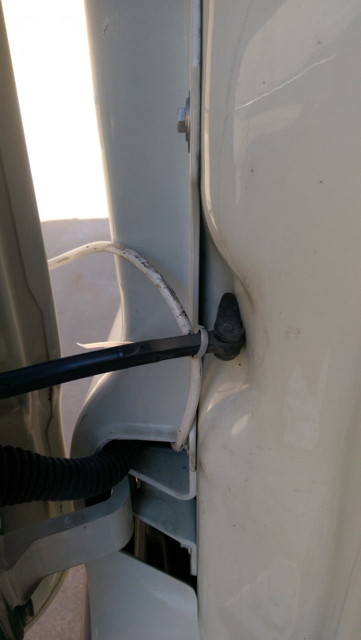

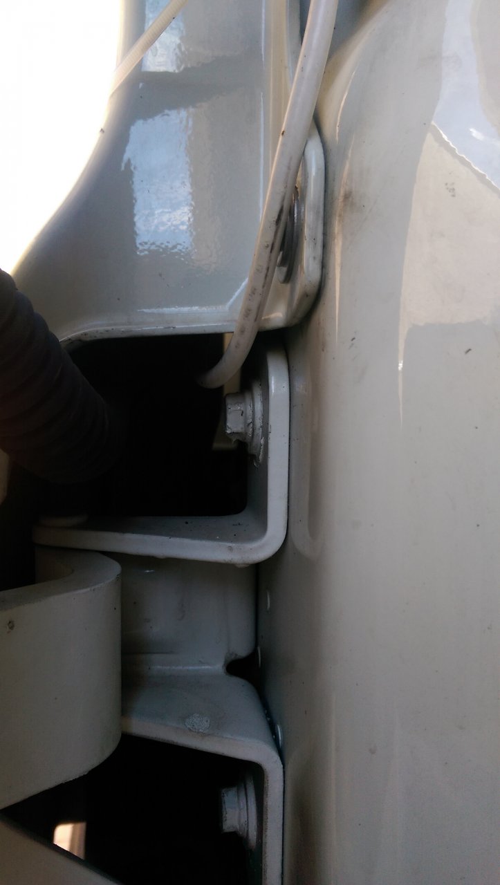

Dont run it through door jam and weather stripping...Run it through door then direct to firewall in engine side...Just look around the steering column for a rubber grommet and run it through there..Comes out by your feet..skulldrinker and slim6596 Thank this.
Coax snakes around edge of the door, then up in side the body, under the hood, to a runner grommet on the firewall. From there, inside the dash to the mount on too of the dash for the radio.

or you can run it across the top
of motor on top of the black plastic air breather crap thru the firewall on the passenger side up into Truck to the radio -
white co ax who the heck even makes white co ax 2nd time I've I've seen it on this forum I dunno ????
